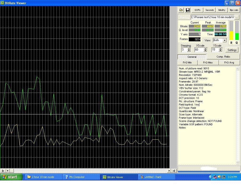

I own the Sony RDR-GX300 and the Pioneer DVR-310. I ran a few test a while ago and I can tell you this.
This is the Pioneer in 2 hour and 10 minute mode

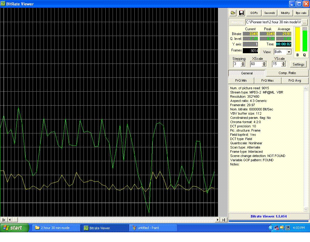

This is the Pioneer in 2 hour and 20 minute mode
This is the Pioneer in 2 hour and 30 minute mode. This is where everything changes.
