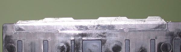

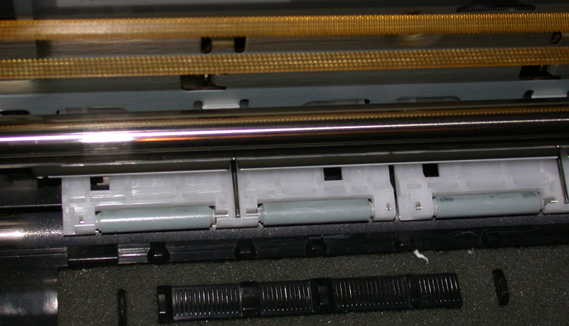

  16. Ok after some looking at this cd tray issue I might have resolved it.
    It looks like it suffers from the same thing that the old crappy HP printers had with their paper feed and I think still do. The tray is fed horizontaly that takes a bit more friction then the top down feed like the paper. The tray is fed by the small clear plastic lip in front of the tray upon 4 rollers on a roughed rod to provide the friction. Now there the rollers are prone to pick up ink, paper dust etc.. to make them slick as well as the clear plastic front.
    So I cleaned the rollers with some Isopropyl Alcohol and then I cleaned the plastic lip with it also. I also put a small dabs of hot glue on the lip of the plastic to make a bit more pressure between the rollers and the rough bar.
    I have yet to push the tray in after 6 prints and I had to do it each time before hand.. hmm..
    Seems like a cheap way to load the tray but I guess for 89 bucks who can complain. Hope this helps someone let me know if you find any other way to help the friction on the rollers..
    Here are some pics of what I am talking about. There are actually 6 rollers but as you can see Epson replaced the outter left (looking at the printer) with rubber (that tends to get slick over time with the above mentioned materials) to aide the tray. I am thinking this is why when you first start to print it takes those two clicks back with the tray before loading.. to get ready to ram it home
    Here are the pics doubt you need them but its for the "corkys" in the crowd.
