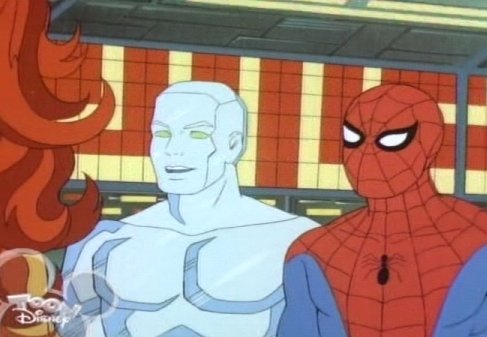

Here's an example of overscan for you boochxo. The first pic here is how the image appears on a TV. This is not from a disc, but as the image appears right off the satellite.

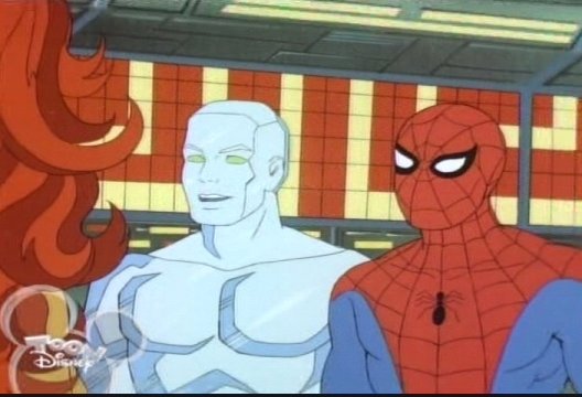

This one here is how the same exact frame appears on a PC monitor. Quite a difference, and if you had only seen the footage on your monitor you'd wonder what the hell was wrong.

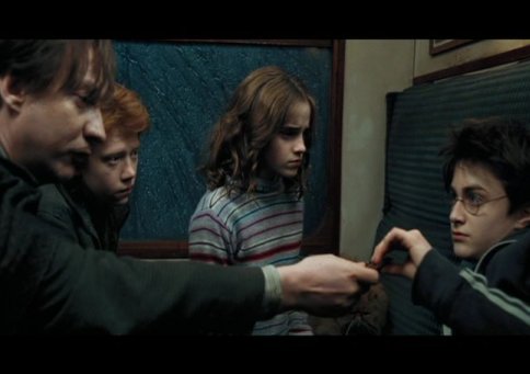

Here is another same frame comparison. This is from the commercial DVD Prisoner of Azkaban. First image is on a TV.

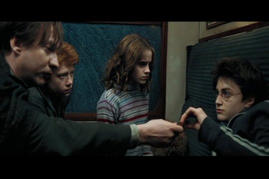

This is the same frame again on a PC monitor.
I will agree with you that sometimes this CAN be a problem. If you're losing the end of credits or subtitles, clearly this should not be so, and adding bars will get the video back onscreen where it's supposed to be. In most cases though, as above, the overscan is 100% normal and does not need to be fixed.
