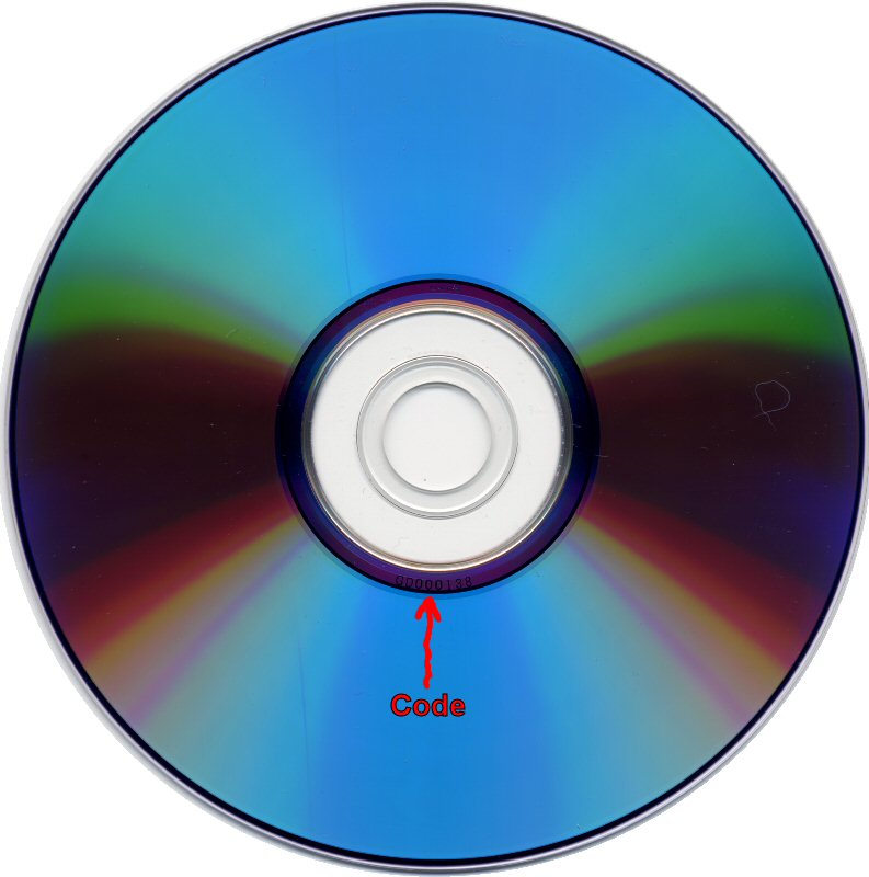

  10. i've used TY for a long time now and they are never cheap and £69 is about the going rate for 100, only a few of months ago you would have expected to pay well over £100.
    Be very careful as there is some cheap media doing the rounds that use the TY media code and these are generally the reason for poor results as TY are at the top of the tree when it comes to quality etc. These low quality fake discs have been reported on many forums.
    As far as i have found genuine TY are only avaliable in tubs of 100 in the UK or 90 for the old 2x media
    http://svp.co.uk/
    (aka blankmedia shop)
    and
    www.jetmedia.co.uk
    both sell genuine TY discs
    If you do buy some of these cheap £7.99 spindles check the centre of the disc in the first part of the dye inside a narrow ring you should look for a batch code something like this
    GG0000XX for 8x media
    GD0000XX for 4x media
    GB0000XX for 2X media
    example:- GD000138 (4x silver inkjet printable)
    If its not there i would say they are fakes as every TY disc i've seen has that type of batch code
    hope this helps

  22. I don't know the in's and out's of Dvdinfopro but if it reads the media code data to display that information then any fake disc that used the TYG02 media code might produce the same information as genuine TY dics, but that would not prove the manufacturer of the disc or the actual dye type used.
    takes me back a couple of years when many manufactures used the TDK media code, but only a few were actual TDK discs.
    Have these disc got a TY serial number in the centre of the disc as shown in my first post
