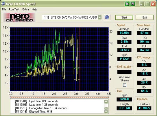

What are the advantages? Here's a screengrab of a burn at 4X on the Fuji TY02. Wish I could make sense of it...
Good? Bad? Ugly? Thanks again! -
why flash it to the next level??? as already stated LITEON BURNERS prefer DVD+R than DVD-R media. in my opinion it would be better just to use the LITEON drive for KPROBE SCANS. Get a Pioneer or a Plextor drive they love TAIYO YUDEN DVD-R media.Originally Posted by daimyodrum

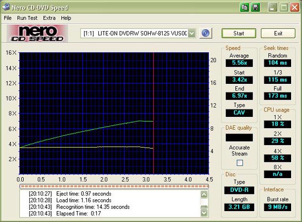

Also as stated:
Here is the same file burned at 8X on the same fuji media (next one on the spindle actually) AFTER flashing it with the omnipatcher,sohw specifics andAs to your real problem. Liteons will do fine with TY -R media. If you are getting a 4X burn there is no problem with your DMA. I would guess that your firmware is not current and is falling back to a slower speed because it can't recognize your media code.
tweaking for this media. Hope this will let me burn off my ritek ridata 4x DVD-R at 8x. I'll find out next...
Looks a lot better to me, 'cept the burn seems to have capped off at 7.0?
and if this is sufficient, I would rather not go spend the extra $ for another burner...thanks again. -
I would say you have solved your problem. Also the 7X you mention is the read speed during the CDSpeed test not the burn speed. Your burning software should indicate the burn speed.
