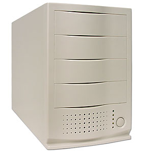

    You can get something like this at Computer Geeks for less than $100. It holds 4 drives up to 120GB each and since it's external you can move it from one computer to another.
    More info here... http://www.compgeeks.com/details.asp?invtid=MAP-504F1-01&cat=CAS

    However the big advantage of having an external hard drive system like the one posted is that you're taking that much more strain off your power supply. You're also getting the heat that brick of hard drives is giving off out of your main case. I highly recommend getting one of the external enclosures like that with a FireWire bridge since with those you can usually turn off the enclosure while your PC is running. If you get hot-swap trays for each slot you can do this individually as well. I've looked into it and decided just to get a server case with room for a second PSU to power just hard drives. Certainly not the cheapest route to go though
