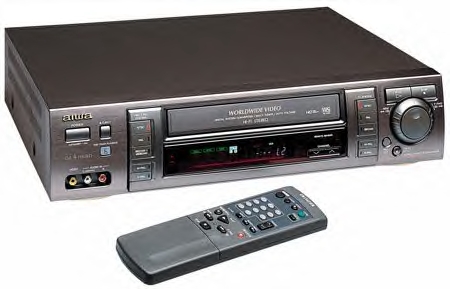

    That is how I do it....Umbearto's way. Get that tape to a DVD first....no matter if it is NTSC or PAL. It is MUCH easier to find a converting DVD player than it is to find a converting VCR.
    Wanna pay up to $600 for a true converting VCR?
    http://www.bombayelectronics.com/vcr/mx100.html
    I own this VCR...though it is back in the states right now.... . I plan to bring it back with me on my next visit though.....GREAT VCR.

    No...this machine converts between the 3 formats. PAL, NTSC and Secam. VHS machines in the UK and Oz output a quasi signal that makes NTSC "viewable" on PAL. They don't convert to a true signal.
    Basically I would insert a PAL tape....press a button....and the output signal is now a true NTSC.....and it works vise versa as well.
    I can also RECORD in any format as well.
