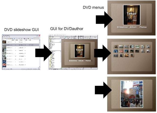

  22. Here's a new release candidate 2. With a bugfix and Gui for dvdauthor export.
    Originally Posted by Aleoink
    I just installed DVD slideshow GUI 0.73 but I can't even try the preview, because when I load the pictures and press the "Preview" button all I see on mPlayer Classic is "ImageReader: error 'Could not open file' in DevIL library reading file C:\Programmi\DVD slideshow GUI\_temp_files\000000.ebmp (C:\Programmi\DVD slideshow GUI\DVDsGUItemp.avs, line25)". When I try to export in any format I get the same error message (of course "C:\Programmi" is Italian for "C:\Program Files").
    This was a very hard one to track down - because it worked fine on my computer, but now I think it is solved.
    Please test the new export to (.gfd) Gui for DVDauthor feature. It also supports export of videos, so this is a nice way to make a video(musicvideos/trailers) compilation.
    DVD slideshow GUI now can export a .gfd file with:
    - Main menu(animated) with button access to:
    - A rendered video slideshow with music, texts and chapterpoints.
    - Chaptermenus with tumbnail-buttons to the video slideshow.
    - One photo/video pr. submenu, so you can flip through photos/videos with your remote.
    Just by exporting your slideshow in .gfd format and loading it up in Gui for dvdauthor, author it and burn it - you will have a pro-looking slideshow DVD with menus:
    Get it here:
    http://download.videohelp.com/tin2tin/DVDsGUI074RC2.exe
    ... and let me know how it works for you.
    Haven't looked on the ntsc 16:9 thing yet.
    Atm only 98 slides are supported, but more will come, when I get the time for that.
    Tin2tin

    @ um3k & iant I'll have to look into that later. I wanted to get the gfd export finished, but I'll be away for the next two weeks, so it will not happen tomorrow....
    Tin2tin
  26. Can you locate what button is too close to what button
    It would be far easier, if you could post the GfD file (as ZIP) anywhere. I think I can locate the button quite fast...
    (I tried to create the DVD without changing anything in the .gfd file)
    If I can add a whish, I would like to create a DVD with more than one slideshow. Could it be possible?
    I need more details - again it doesn't make this error on my computer. Can you locate what button is too close to what button(by deleting them one by one)?
    Unfortunately not. I tried, but can't understand what the real problem is!
    It has almost taken me 3 weeks to get this to (almost) work. The massive XML scripts used by GFD are driving me nuts, and only by the help of Borax I stayed sane. So more slideshows will be too much for me
    OK, it was just a wish!
    Thank you again for all!
    I put a ZIPped GfD file here:
    http://www.motosardi.org/file_transfer/polverosi.zip
    Thank you for all!
    Alessandro
  29. I have the same problem as tin2tin... The error doesn't occur on my computer. Could you at least locate the menu? Just open the menu in GfD (start with MainMenu, continue with titleset1 menu an so on). After loading each menu just click on preview. If there are buttons to close, it will also be mentioned in the preview.
    My theory for this problem are different used fonts or different screen resolutions (<> 96 dpi)
    Thx for the hint!
    The problem occurs on TS1SubMenu1 (where the thumbnails are) but I can't see any text there and my screen resolution is 96 dpi.
    Alessandro
