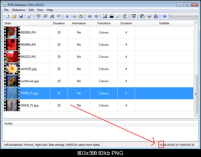

    @ askirk64 In the lower right corner there are numbers changing you you left clickon slides - this way you can find number #48. When you found it try to re-save it as I mentioned or hit the del key or the cut icon for deleting it.

  11. [HTMLaskirk64 In the lower right corner there are numbers changing you you left clickon slides - this way you can find number #48. When you found it try to re-save it as I mentioned or hit the del key or the cut icon for deleting it. ][/HTML]
    Tin2Tin, I've tried to find the number in the right corner which is not there, so after days still not luck with finding slide 48, please help.

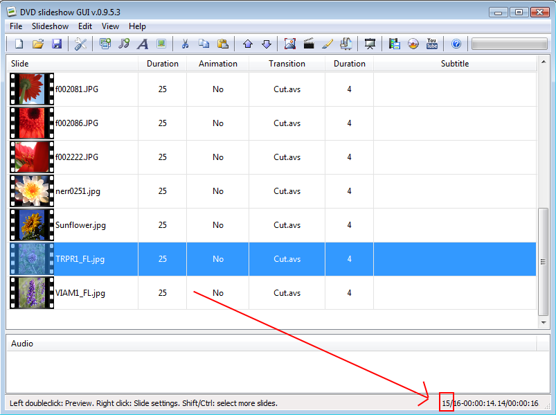

  12. Click image for larger version
    From the manual:
    Status Bar:
    Right Side:
    The number of the selected slide out of all slides. Ex. 3/7 means 3. slide is selected out of a total of 7 slides.
    The time of the selected slide will be shown out of the total duration. Ex. 00:00:19.00/00:00:57.00 means the selected slide will be shown 19 sec. into a slideshow with a total duration of 57 sec.
