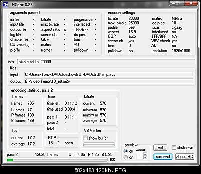

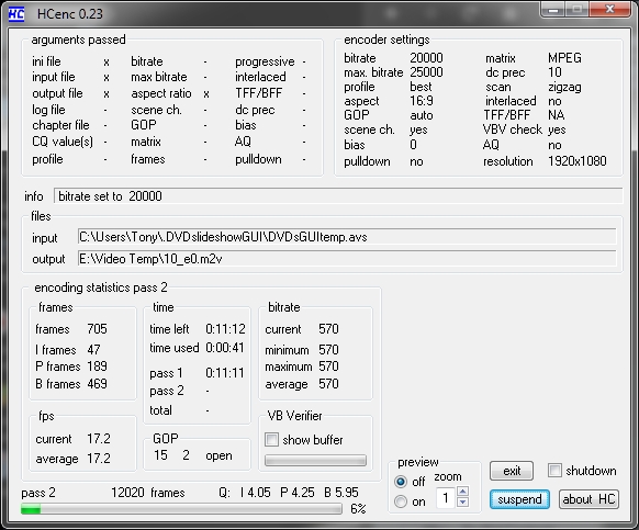

    I found a new error, if I insert a small .avi clip just as the processing begins for BR this appears
    I tried to track down samples, no luck. I have no idea what this error is referring to.
    thanks
  14. I'm puzzled over that HCenc memory allocation error you're getting. I tried your file and it renders fine here on my old Vista computer. Are you using the DSG included Hcenc or a newer version?(As far as I remember the newer ones causes errors with DSG).
    Attachment 13756
    This is also a HCenc error? It doesn't look like a DSG error.
    If your preview in DSG shows images and audio and not a text error - then it is not Avisynth script or DSG related, but a question on how HCenc works on your computer. Which I do not know much about since I not the coder of HCenc.

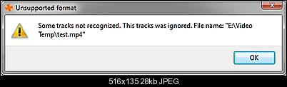

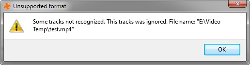

    If you're aiming a making a BluRay from DSG you could try to export as mp4 and add that file manually to tsmuxer(I haven't tested it). The mp4 files are rendered with ffmpeg.
    the mp4 has no chapters, as expected, and plays fine. Tsmuxer chokes on the file however.
  19. I wonder if x264 as an alternative to HCenc can be used for making files tsmuxer will accept and what command lines to use for 1080p and 720p?
