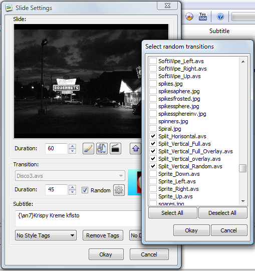

  5. Here's a new feature I've been working on:
    It's for choosing the array of transitions the Random function should choose from. It very nice to add a "family" of transitions like all the wipes to the first 20 slides and a different "family" for the next 20...

  7. Here is the DVD slideshow GUI 0.9.5.1 Release Candidate 1 for testing.
    The two new features to test:
    - Import of all files which succesfully wraps in an avisynth script using ffmpegsource2 as importer. This means that that files like mpg, mp4, flv, tif, tga and many more now can be imported in DVD slideshow GUI, however imported files that are unseekable will cause playback errors when previewing, but rendering should be all right. Images will get a duration set in the Project Settings menu, and can only be changed in AvsP.
    - Select the array of transitions the random function should pick transitions from.
    Download here: http://download.videohelp.com/tin2tin/DVDslideshowGUI0951_Release_Candidate_1.zip
    Unzip and add/overwrite the files to an installed DSG v. 0.9.5.0 main folder.

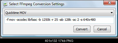

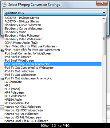

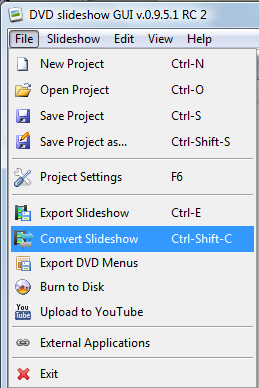

  15. New DSG patch 0.9.5.1RC2 now with a FFmpeg conversion feature(will add a lot of new formats to convert slideshows to - NB only for testing!):
    Download here:
    http://download.videohelp.com/tin2tin/DSG0951RC2_Patch.zip
    [EDIT: I would just like to add that now DSG with this patch is it can import anything ffmpegsource can import(with an automatic Avisynth wrapper) and it can convert to anything ffmpeg supports.]

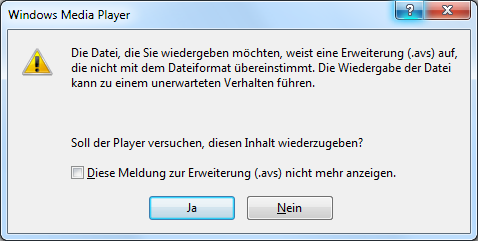

    But at the moment I have a much, much bigger problem: DVD slideshow GUI is not working proberly on my Windows 7
    I get the error message shown in attachment.
    I've tried many things, reinstalled k-lite codepack and even liked to deinstall the Media Player (I don't like it, don't use it), but couldn't find an uninstall function.
    I needed a lot of time to figure out the following:
    1) the error message says something like "it's avs extension, but not avs-content."
    2) the window shows "Windows Media Player"
    My thinking:
    yes, it seems it's Windows Media Player and of course, this player can't play avs.
    So my questions:
    is DVD slideshow GUI realy using Media Player, or should be used Media Player Classic (which can play avs) instead?
    why the Media Player is used, or better: how could I make it, that the MPC is used?
    Maybe (hopefully) this is enough info for giving the sollution, so I'll stop writing here.
    Onlay like to say: I haven't such problems anywhere else, avs is working (with VirtualDub and also MPC), I could also export slideshows with DVD slideshow GUI. But the preview is not working, opening "Project Settings" also not and most terrible, the main window is always loosing focus.
  17. I think that animating the the opacity too sounds like a fun idea, but it will be too complicated for me to code.
    My German is limited, but what happens if you click the checkbox and then 'Ja'? (To allow WMP to attempt to play the avs file and remember that choice)
    Sorry, I thought I was close to the sollution and no detailed translation would be needed.
    The translation (googled - should be shown on an english windows) is this:
    "The file you are attempting to play has an extension (.abs) that does not match the file format. Playing the file may result in unexpected behavior. Do you want the Player to try to play this content?"
    Of course I've tried it (saying yes) and unfortunately I've checked the box from the first time. So this box never shows again (for the screenshoot I used an other user-account) and I can't figure out, where this info is saved.
    Using "always try it" is the most worst situation, because the following:
    1) opening "slide settings" => simple no animation
    2) opening "Project settings" => showing "opening media", and do this again and again => every second the focus is lost, so if I push any pull-down button, the pull-down-menu is gone away very soon (faster than I can click any menuitem)
    3) being in main window (don't know exactly when this will start - probably after going into "Project settings" and left it), the same behavor as in 2, says: selecting anything, opening pull-down-menu - very fast selection, menu, ... is gone => not usable
    In the meantime I've tested an other windows 7 computer (mostly clean installed, it's a simple test-pc, same windows media player than on my pc: 12.0.7601.17514)
    have installed only DVDslideshow and avisynth, I was wondering:
    1) the preview in slide settings is working
    2) but entering "project settings", same problems
    3) opening avs work neither with MPC, nor with WMP (but as told: it's only a simple test-pc, not even k-lite codepack or any other video-software installed)
    Strange.
    At least I would like to get the message-dialog back for my main-user, so I could select "never try it again".
    Need help, don't know what to try more!

    Also I don't understand, why animation is working in preview (on the other computer), but playing avs directly in WMP not.
    You can play avs also in WMP? Ohhh, I should test it also on the XP computer, I'm also using ... and I can do it on a virtual machine, now: yes, XP and WMP 9.00.00.4510 can play avs (also with the same message, but saying "yes" is working here)
    I wonder if there are any other DSG users on Windows 7 who can enlighten us with the fact if this is a local problem or if this happens on all computers with Windows 7.
    Yes - any other Windows 7 user here???
    Anybody using Windows 7 + WMP 12.0.7601.17514?

    Maybe Win 7 already have some other avs decoder installed(which is not decoding Avisynth scripts), just a guess...
    I don't believe so.
    I belive much more, that Win 7 and WMP 12 is not at all able to play avs.
    Nevertheless a LIIIIIIIIIIITLE success:
    bringing the box back is written in the following registry key:
    HKEY_CURRENT_USER\Software\Microsoft\MediaPlayer\P layer\Extensions\.avs
    (But using the "project settings" window still not realy possible.)
