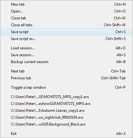

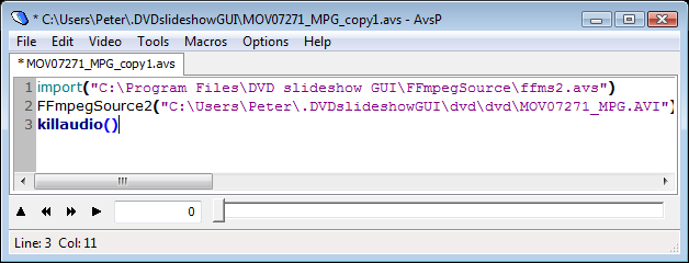

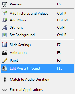

  16. @ minifig I've just teste those files and it seems that Avisynth (ffmpegsource plugin) is choking on the audio. That' s what it is saying, when double left clicking the video clip in the listcontrol.
    [Attachment 7742 - Click to enlarge]
    To avoid loading the audio into DSG - you can do this:
    If you select the videoclip and click Slideshow > Edit Avisynth script
    [Attachment 7740 - Click to enlarge]

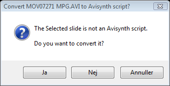

    Find the path of AvsP.exe in c:\AvsP\Avsp.exe.
    [Attachment 7745 - Click to enlarge]
    Say Yes to convert - nothing will happen to your original file. DSG is just creating a script wrapper.

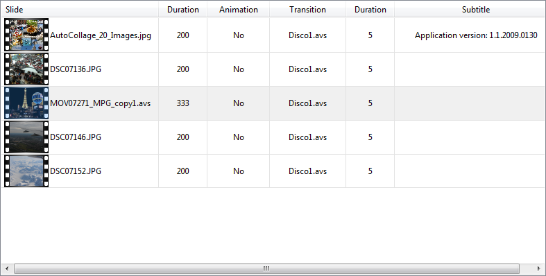

    In AvsP add one line:
    Killaudio()
    [Attachment 7744 - Click to enlarge]
    Save under the same name and close AvsP.
    [Attachment 7741 - Click to enlarge]
    Now the audio isn't used from the clip any more. Notice that the extension of the video file has changed to .avs (avisynth script).
    [Attachment 7743 - Click to enlarge]
    Now you slideshow runs/exports without any problems (here on my computer).
    [BTW all the PAR 1:1 seems to come out wrong - so better not use it until I'll get the time to fix that]

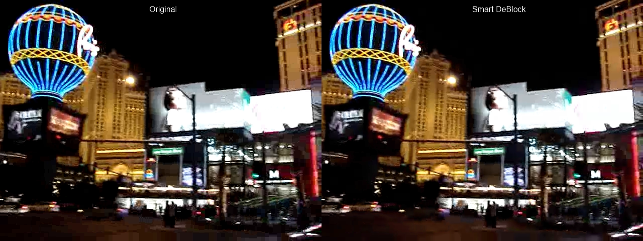

  20. Did a search on that error message - and it might be related to a bug in the ffmpegsource plugin for Avisynth. You could try to update ffmpegsource by downloading this file here and copy the included files into the 'C:/Program Files/DVD slideshow GUI/FFmpegSource'(or where you've installed DSG) and overwriting the old files.
    It seems to me that the newer version of ffmpegsource accepts your videofile including the audio - is exports without the error here.
    Actually you clip could use a bit of deblocking. It can be done by making an Avisynth wrapper - as descriped above and follow the instructions on this page using the MSU deblocking filter in the avisynth script. However an extra line of code must be added in the end of the script: 'converttoyv12()'
    import("C:\Program Files\DVD slideshow GUI\FFmpegSource\ffms2.avs")
    FFmpegSource2("C:\Users\Peter\.DVDslideshowGUI\dvd\dvd\MOV07271_MPG.AVI")
    LoadVirtualDubPlugin("C:\Program Files\DVD slideshow GUI\MSU_SmartDeblock_0.8.vdf","MSU_Smart_Deblocking", 0)
    ConvertToRGB32.MSU_Smart_Deblocking(1, 1, 1, 1)
    converttoyv12()
    ... so the script looks like above and correct the path to where you unzip the MSU_SmartDeblock_0.8.vdf file. Save under the same name and close AvsP.
    On the 16:9 vs. PAR 1:1 issues am I thinking about dropping the 1:1 option - the result looks the same anyway.

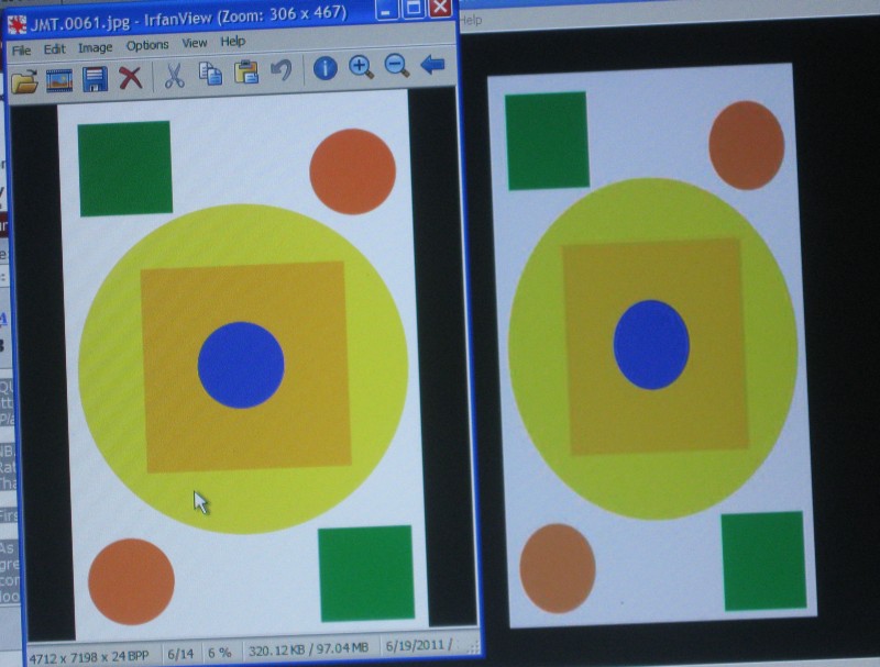

  24. @ Frovingslosh - try this one:
    http://download.videohelp.com/tin2tin/DVDslideshowGUI_calibration_test.exe
    (Place it in the DVD slideshow GUI folder and run it by doubleclicking it...)
    NB. you may have to change det resolution setting in Media Player Classic by right click > Video Frame > Override Aspect Ratio > Default/4:3/16:9
  25. Originally Posted by tin2tin View Post
    Thank you. This is a huge improvement. I don't believe it is perfect yet, but it is greatly improved.
    First of all, the animations seem to be properly positioned, not offset to the right as they were in the past.
    As to the images themselves, I believe that they now are a bit taller and narrower than should be. In the past the error was greater and in the other direction, that is people looked short and fat. Now they look thiner and taller, which may get fewer complaints but still isn't what you want. Notably, the test image of circles and squares that I passed to you previously now looks like a slightly vertically elongated oval rather than an oval compressed in the other direction.
    I've only done my testing at 16x9 NTSC 1:1 pixel aspect ratio. I'm not clear about the media player classic settings, my copy of MPC doesn't quite match what you describe. I have a "Keep aspect ratio" setting when I follow the options you gave, which was checked. Below that is a "correct monitor/desktop AR difference" option was was not checked. But I have played with checking and unchecking all 4 permutations of these options and it doesn't seem to change the visual effect. Maybe I need to get a newer copy of MPC. But MPC isn't really the issue. I played back the resulting AVI file in VLC and saw the same thing that I saw in MPC. The image was slightly elongated in the vertical direction. I confirmed that the PAR of the produced AVI file is indeed 1:1 (using gspot). And it really doesn't matter what my media players are set to, I (and I expect other users) want my resulting video to play back on other systems and on non-PC devices, not just my own specially tweaked system.
    I also considered that my monitor might not be adjusted perfectly, since the monitor does have both horizontal and vertical width adjustments. If either were off it could certainly cause what I am seeing. But I've satisfied myself that this is not happening, as the original source image of the circle and squares image looks fine on the same monitor. So it is getting slightly compressed in the horizontal direction while being converted to video. I wanted to send you a screen shot of the two side by side, but unfortunately a PC screen shot fails to capture the image from Media Player Classic or VLC and that part of the screen is just black. So I've resorted to a crude digital camera screen shoot of the screen with the images side by side, the original JPG is on your left while the MPC result is on your right. Also in this example is it evident that the video creation process has dulled down our colors somewhat. I'm not concerned about that yet, and I expect that one way or another I'll be able to compensate for that. But I'll mention it now so that you can start to think about it. Perhaps I need to start trying to learn how to use those project pre-processing and post processing effects to compensate for what I'm seeing here;.
    So I hope that my feedback is not leaving you thinking "these users are a pain and are never satisfied", but rather see this as feedback that a lot of progress has been made but a bit more is needed before the next version of this part of the tool is ready for release. If, as it seems, it is just a matter of calibration and getting a few parameters zeroed in so that the output looks right, I'm very willing to do what I can to help finalize the calibration. If the parameters could be passed in through a file, or by in-line switched, or even by hex editing the file, I would be very happy to play with the settings until I get an image that looks correct.
  26. Okay, now I force Pal + Ntsc 16:9 PAR 1:1 to 720x432:
    http://download.videohelp.com/tin2tin/DVDslideshowGUI_calibration_test2.exe
    If you check "Keep aspect ratio" then the override aspect values will have an effect. These are to be used if you need to force a different AR on material. If you want a 1:1 AR you'll need to uncheck "Keep aspect ratio".
    "Correct monitor/desktop AR difference" - my guess is that checking this, will ajust ex. a DVD made for tv Display Aspect Ratio to a computer monitor DAR. So when playing DVDs in MPC this should be checked.

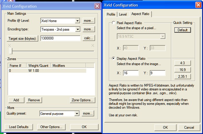

    BTW. AVI is just a container, and it isn't capable of storing either Pixel Aspect Ratio (PAR) or Display Aspect Ratio (DAR). Same thing with Avisynth scripts, which means previews in DSG will not be automatically corrected, however exported MPG files does store 16:9 and 4:3 info.
    Actually, my experience is a bit different. I do make a lot of XVID AVI files in VirtualDub and I use PAR and DAR settings inside of XVID to get my aspect ratios correct. Prior to doing this I had some display problems when playing back these AVI files in my BluRay player, but with the correct settings (and a few other tweaks and filters) the files look fantastic. There is indeed a warning that states that IF AN AVI CONTAINER is used the PAR/DAR is LIKELY to be ignored in some players, but my experience has been good. XVID Codec screen shot attached.
    However, I'm certainly not comitted to using AVI, it just seemed like a good compact choice both for testing and posting to the web. If you would recommend that I use mpg files or any other format when I select the EXPORT option in DVD Slideshow GUI, then just say so and I'll go that route and make it a non-issue.

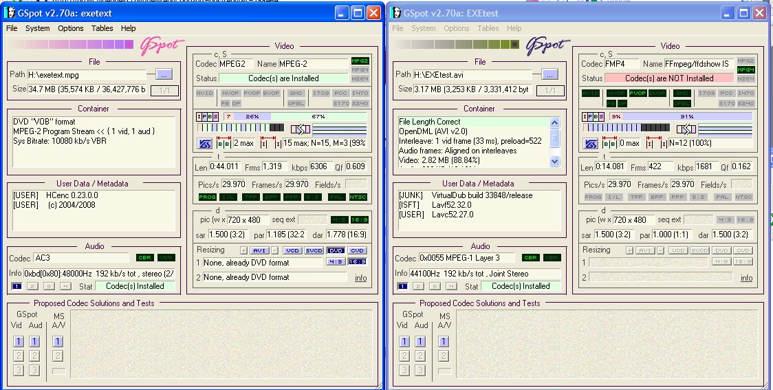

    And the best news is that I ran another test with an MPG file as the output. and it indeed does look much much better with the mpg file rather than the AVI file. So while I'm still a fan of XVID AVI files, not so much with these AVI files. I'll go ahead and use MPG files as my DSG output.
    By the way, the MPG file does still have the same issue as the AVI file of the colors not appearing as saturated and the whites no spearing as white as they do in the original image.
    You may be wondering just what is different between the AVI and the MPG files such that the MPG file would look right and the AVI file would look wrong, I certainly was. So I looked at both files with gspot. It reports that the AVI file does indeed have a 1:1 PAR, but that the MPG file actually has a 1.185 PAR. And, of course, that makes all the difference. A shot of gspot examining both files is attached, with the MPG file on the left. So it looks like I may be using a file without the expected 1:1 PAR to make my DVD, but I'm much more concerned with what looks right than what the intermediate file settings are. I'll make a test DVD with both the AVI file and the MPG file to confirm that the MPG file is the one that needs to be used for final DVD production, it is certainly the file that is needed if you are distributing the widescreen output of DSG directly to others.
    If you want to tinker with how videos are generated - export as .avs and open that file in AvsP/Notepad.
    I'll be glad to go that route (if there is still any reason to play with the parameters). However, I'm not clear on how I manage to export this file. I can find the control to export a slide to a script, but how do I get DSG to export the scprit of the entire animated slide show in a way that I can grab a copy? Or am I even so confused that this question doesn't make sense?
    So at this point the first of the two EXE files looks like it is going to do what I want, as long as I export to MPG and not AVI. I have not worked with the second exe file, the 720x432 one. I'll go ahead and at least try that and see what it does, but as I said 720x432 doesn't seem right. It is very late here and I want to be alert when I do any testing so I'm not going to do that now.
    I should also mention that I did a bit more testing prior to getting your last post. While I previously reported that the animation does not have the large offset to the right that it did in previous versions of the software when doing NTSC 16x9, I found that it does have a slight offset. This offset is minimal, and I was only able to notice it by putting two duplicate images back to back in the slide show, displaying the first unanimated and the second animated (but with a few seconds of still image at the start of the animation). In that case you can see a slight but obvious shift in the image to the right as it transitions to the second image (use a cut or dissolve rather than a fancy transition). You might not find this worth fixing, but I expect that you now know this part of the code quite well and as a tester I would be at fault if I didn't mention it.
