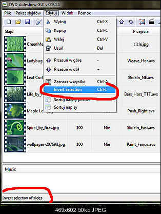

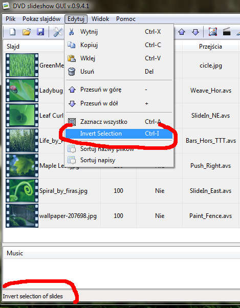

  9. I've problem with "Invert selection" in polish translation. It's translated in launchpad, but not in app.
  10. I keep having a problem when exporting a slideshow with the PAL-settings. I get an extra subtitle. It is not there when I choose NTSC-settings. Also the preview looks fine. What tot do?
  11. @ Invert Selection - good find - will fix that.
