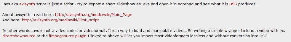

    I will give the MP4 output a try, I have not yet attempted to do the process of .avs text wrapper. I'm sure it is very easy although I have never done this such procedure every before. I should learn it, and will try this. I am laughing now as I ever think about it. this should be very funny to see me do this. Also I may export as MP4 and convert to DVAVI in Super and re-import that way. For some reason I just haven't got a grasp on what it even means to "wrap" the MP4. https://forum.videohelp.com/threads/188464-DVD-slideshow-GUI-development-thread/page40
    I will be glad to learn this as it seems to be important, I just wish someone could just show me or I wish I already knew how to do it.
    I will also definitely try to export to avs and see it open in Super, that would be as nice. I just really want (for the purpose of everyone here) to stay within the realm of the DSG, and keep Super out of it for everyone that is here within DVD slideshow GUI.

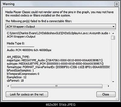

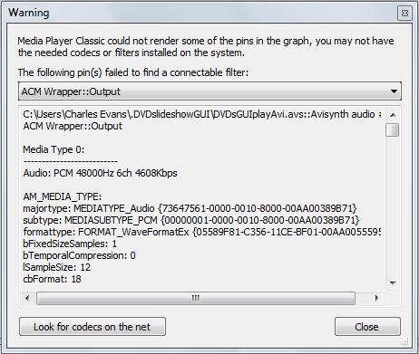

    I may have gotten it I looked at the Beginners guide and edited the avs file script and saved it and put this in DirectShowSource("c:\Users\myname\Desktop\myclip.m p4")
    The file .avs imported into the DSG and seems to be working. I double clicked on the imported file and got this message
    But closed the warning and the Media Player Classic Home Cinema played it anyway.
    I may be getting close to working some of this. Thanks I will keep fooling with it for a few more hours. This looks to be really cool and may have solved this silly situation I am creating.

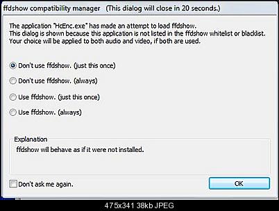

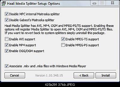

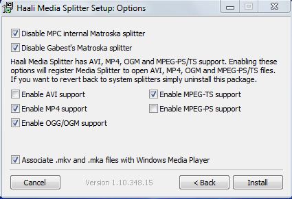

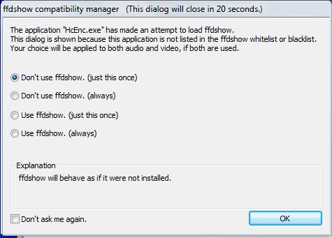

    Question, during a screen of my install today of the MatroskaSplitter is this correct, or should I have checked the AVI and MPEG-PS radio buttons?
Name:	install screen.JPG
    I can not insert a jpg here of that. Darn. I will ask a short version on the thread. Also I'm seeing this message often when using file during and around operations concerning the DSG. Asking whether and when to use ffdshow. I was wondering what would be the best answer for this pop-up.

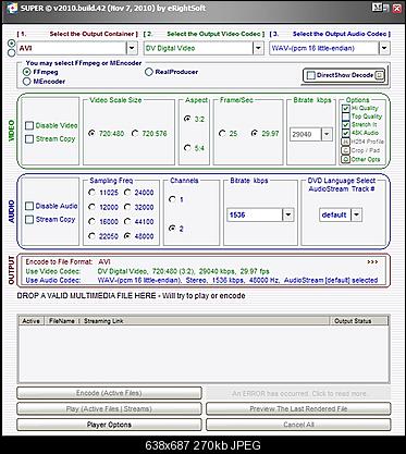

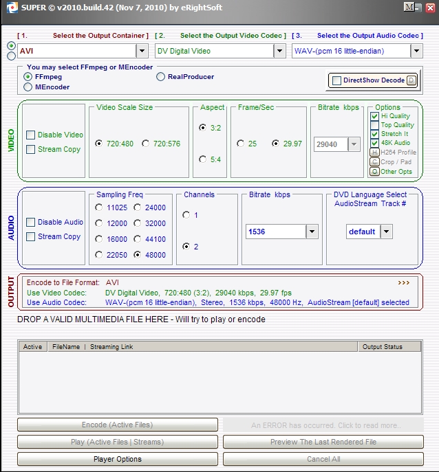

    and here is that DVAVI preset for Super I previously mentioned for Premiere. It works like a charm, and the DVAVI files from this preset as well as the default render from Premiere drop smooth as silk into the DSG.
Name:	DV AVI for Premiere.JPG

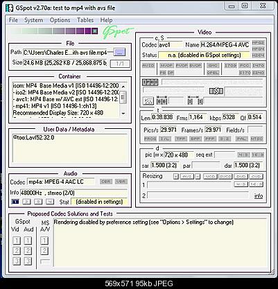

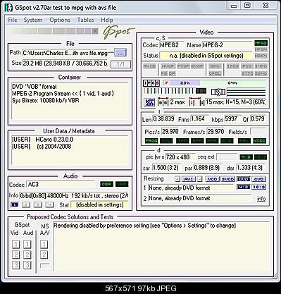

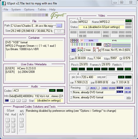

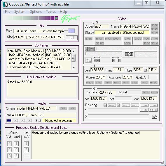

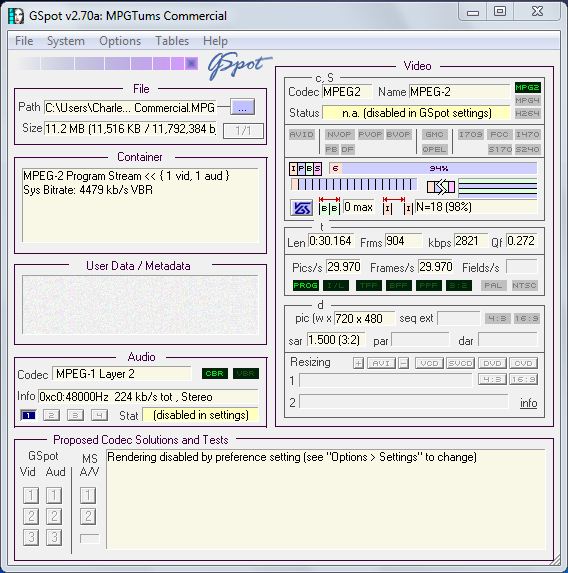

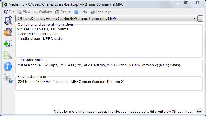

    Choosing mp4 to export the highest quality file was a good choice, but here is the GSpost info on what I'm getting side by side with the mpg export.
Name:	MP4 export.JPG
ID:	4588Click image for larger version
Name:	mpg export.JPG
    So do you still think I should stick with the mp4.
    Just looking for your opinion.
    An interesting note : even as the DSG handles the mp4 input when wrapped avs my computers get pissed when playing the mp4, but play the mpg file just fine. If the mpg export quality is in your opinion as good as the mp4 export, it may be convenient for me to use the mpg export. Windows 7 media player doesn't play the audio on the mpg export but that's normal on this system... I deal with it. I just play the mpg files in Medial Player Classic or Zoom player.
    For what it's worth, my TiVo really likes the MP4 export form the DSG, the TiVo likes the mpg export too.
  18. If ffdshow works as a decoder for the formats you'll let it decode - this can be a good thing so you could allow it to process the files. AFAIK this is actually the reason DirectShow will take more formats. When working with mp4 the haali may be enough. I'm not that much on top of the whole codec/video.
    The ffmpegsource way will give you much better decoding and playback, so if you want to throw a lot of different codecs at Avisynth/DSG this is will the most succesfull imports. Did you see my post above with ffmpegsource instructions? I don't know the reason for spliting up the slideshow into more mp4? If it isn't because you're hitting the roof RAM vise, you should use .avs(with no subtitles) and get a lossless process till you export that slideshow consisting of .avs files.
    @ Gavino - thanks for the heads up on the audio. Didn't check the code.

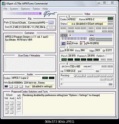

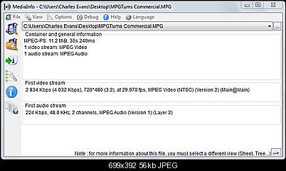

    @Gavino Yea I saw that file being created on the desktop, I believed I didn't need that
    Yes the video has an audio track, I did not have mediaInfo, but got it for your answer. I use GSpot.
    The red text is in the avi export and is upside-down and may even be in a language other than English, so I have been just deleting that junk avi exported file.
    @tin2tin I am trying the deal whereas I dropped the items into that plugins folder as soon as I can. I would expect that I may have done something wrong and won't be supprised is that either works or doesn't work. I will post back here as to whether that method has any result either way.
    It looks like standard mpg file audio to me, so I don't know why ffms2 can't handle it.
    Having said that, the usual way to load mpg files into Avisynth is to use DGIndex, which is yet another thing for you to learn (although it's not difficult, and has good documentation).
    If you follow tin2tin's advice and use AvsP to load your script, you should be able to get a clearer error message.
