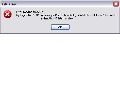

    Crash when adding Audio
    With version 9.3.8 I cannot add audio, specifically mp3, to slideshow. See attachment for error message.
    I start DSG and immediately try to add a mp3 file. I tried several files, all give the same problem. After the first error message there is one more message and then DSG crashes.
    I noticed that DSG created a file .d2a in the directory where mp3 is located.

    Apparently that audio bug was introduced during the implementation of the video editing code. Damn - but thanks for letting me know. It's not that hard to fix, but making and releasing a new installer takes me a couple of hours each time. And my work situation is killing me at the moment...
  4. Fixed that audio bug and uploaded DSG under the same name, so please redownload DSG 0.9.3.8 if you encounter this problem.
