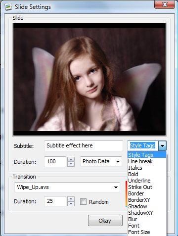

  18. A video of some of the new subtitle effects(VSfilter) in the upcoming DVD slideshow GUI version:
    http://www.youtube.com/watch?v=0aNDqyl2Pe0
    The new Subtitle effect function:
    The new PAR(Pixel Aspect Ratio) function:
    Get the 0.9.2.2 version of DVD slideshow GUI at the homepage - link at sigature.
