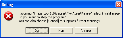

    I save and close DSG. When I reload the project with DSG, I have the attached error message, I click 'Cancel' to continue.
    The final log writes a lot of lines like those:
    22:19:16: No handler found for image type.
    22:42:29: Couldn't add an image to the image list.
    I look in DSG: icons of images are displayed for videos, instead of the standard video icon. And the last images have no image icon. Finaly, the number of errors is equal to the number of videos...
    DVD slideshow GUI is always the best slideshow creator, great job!
  26. Yes, that sounds like a bug. I actually can't remember if I checked saving/loading of avi/avs in dsg files works. I will try to look into that when I get the time.
