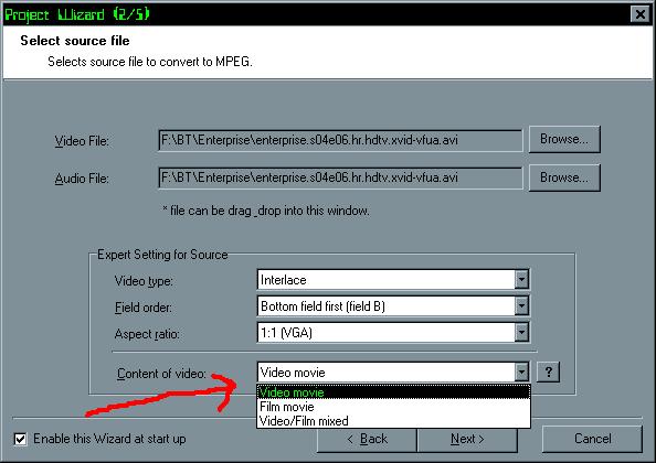

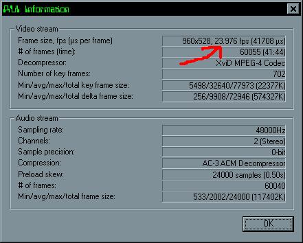

I have an XviD that VirtualDub indentifies as being 23.976 fps.

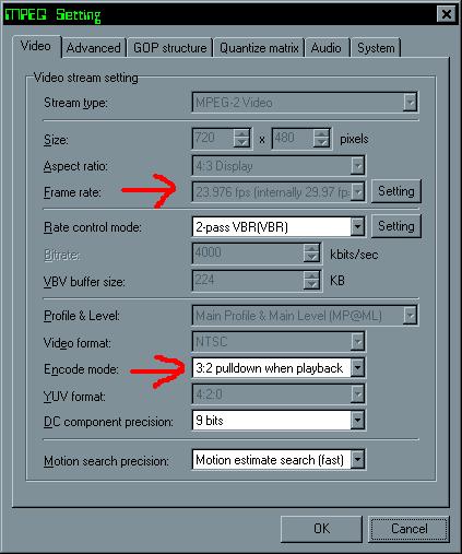

When I import it into TMPGEnc Plus 2.58.44.152 to convert it to DVD-compliant MPEG-2, the Content of Video section reads Video Movie, and on the Video tab it indicates a framerate of 29.97. But if I change the Content of Video to Film Movie, on the Video tab it says the framerate is 23.976 fps (internally 29.97fps), and the Encode Mode now reads 3:2 pulldown when playback.
First question: I should do this with a 23.976 source, right? I mean manually change the Content of Video to Film Movie?

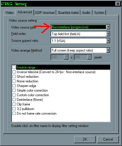

Second question: If I do that, in the Advanced tab Inverse Telecine is now checked. Should I leave it checked or not? And should I check the 3:2 pulldown box or not?

When you say "leave it at 23 fps," you mean change the Content of Video from Video Movie to Film Movie, as I describe above, so it will be read and encoded by TMPGEnc at 23fps?
I ask because if you use TMPGEnc Xpress, it automatically applies a 3:2 pulldown flag when encoding a 23.976 fps source, right? -
If the source is 23.976fps then you want to set output framerate to 23.976fps (29.97fps internal) and you want to enable the 3:2 pulldown when playback. This is all on the video tab.
For such a source you should not enable the 3:2 pulldown or IVTC filters on the advanced tab. IVTC is for a 29.97fps that you want to convert to 23.976fps, and the 3:2 pulldown filter is for converting 23.976fps sources to 29.97fps.
TMPGenc thinks you have a 29.97fps source. When you tell it you want to output to 23.976fps it assumes you want to convert to this, meaning it must be inverse telecined, so that's why it enables that filter. Since your source is already 23.976fps there is no reason for this. This is why you should not trust TMPGenc's source analysis function. Honestly, I think you'd be much better off if you just disable the silly wizard altogether. -
But those options are only there if the Video Content is changed to Film Movie. Otherwise it's grayed out at 29.97fps.Originally Posted by adam
OK, so I do have to change the Video content to Film Movie (so I get 23.976fps (29.97fps internal) and 3:2 pulldown when playback on the Video tab), then I UNcheck IVTC on the Advanced tab, right?
Thanks for the clarification.
I guess TMPGEnc isn't recognizing my 23.976 source correctly, then. I've got to do it myself.

Yes FulciLives he will have to otherwise set his source info correctly, so it should be set to non-interlaced on the advanced tab.

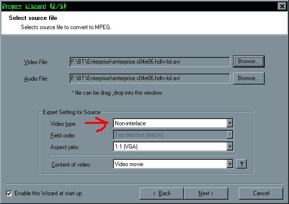

...because 23.976fps is progressive, not interlaced like 29.97fps is, correct?Originally Posted by adam
So, you say to set it to non-interlaced on the Advanced tab. I also noticed that if I set it to Non-interlace on Expert Setting for Source | Video Type, it then shows up as Non-interlace (progressive) on the Advanced tab as well.
23.976fps and 29.97fps can both be either progressive or interlaced. But a 23.976fps source will typically be progressive, and if it originated from a DVD then it will almost surely be progressive.
Yes, changing the source settings in the wizard apply those settings to the normal settings windows in TMPGEnc. Its just a front end. In my opinion it just makes things more complicated. -

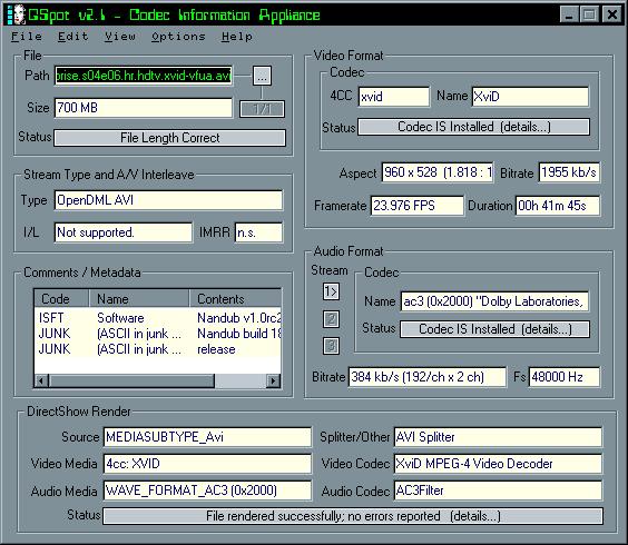

How about an XviD made from an HDTV broadcast, will that typically be progressive or interlaced? Offhand, I would guess progressive (i.e., non-interlaced), but is there a quick way of checking whether an XviD is progressive or interlaced? Something quick and easy, like GSpot? Unfortunately, GSpot doesn't indicate progressive or interlaced...
...and neither does Vdub.

A follow-up:
UNchecking Inverse telecine, as you suggest, produced a horribly jumpy and out-of-sync MPEG-2 file. I encoded again, this time leaving it checked, as it is by default, and the result was a good encode.
So, manually choosing Film movie for Content of video, then leaving all the defaults, except for Full Screen (keep aspect ratio) of course, produce the correct results in my case.
A 23.976fps source cannot, and should not, be inverse telecined. I cannot speak for what TMPGenc is doing but since it is incorrectly detecting your source to begin with, I think its naturally possible that is it treating your source incorrectly. Once again, the best suggestion I can give you is to just disable the wizard.
