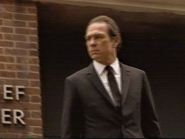

  8. Here are a couple of screenshots...two consecutive frames. These are AVI caps from VHS using Huffyuv, with no filters or anything.
    (I originally screenshot these in PNG format, but I had to convert them to JPEG to get below the 150k limit to post.)

  11. You're captures are prefectly normal. If you want to understand what's going on, this page has an explanation of the issues involved (interlace, 3:2 pulldown, inverse telecine, deinterlacing):
    http://www.doom9.org/ivtc-tut.htm
    If your final destination is TV you don't need to do anything except ignore the interlace artifacts on the computer. If you want something that plays well on the computer you can either use a player that supports deinterlacing on the fly, inverse telecine the video back to the original film frames, or deinterlace (worst choice).
    If your final destination is DVD you should record at 720x480. 640x480 isn't a valid frame size for DVD -- you'd have to resize it after capturing, a time consuming step.
    There are some issues with BT chipsets. Some don't capture very well at certain resoultions. You may need to capture at a particular size and scale later to get the best results. Search this site for others who use the BT878.
  12. Yes I agree, the captures look normal for interlaced video.
    And yes if you can capture at 720x480, or 704x480, do it.
