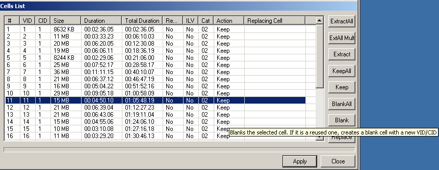

    I just tried it out and VOBBlanker definitely can ...

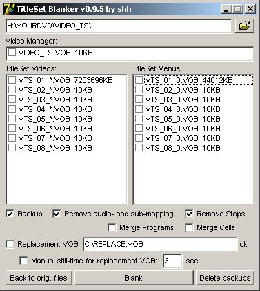

    I think titlesetblanker does what it's called, it blanks titlesets so I doubt you could use it to blank specific songs within a VTS
    Vobblanker let's you mess on with stuff at cell level but it takes some getting used to but it will blank them out

    I've just played with them recently and Vobblanker looks good but it reminds me of DVDStripper (hivers down back as DS was awkward to use and took some getting used to. I don't think titlesetblanker allows you to do anything apart from blanking complete titlesets
    here is the videohelp pic of it and you can see just titlesets

    I confirm: titlesetblanker would not be able to delete individual chapters, unless they were in different titlesets (very unlikely). Vobblanker is the best free tool to blank stuff, down to the cell level, so that would definitely be your best choice here. Of course, it will not mess up with your menus, so I'm wondering what will happen when you select a song you've blanked. In any case, if you have a problem there, you'll be able to fix it with PgcEdit!
