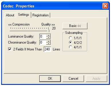

    Here is how I do it:
    This is what it looks like on the 20 (highest) setting:
    The only reason I don't use the 20 setting is because I drop frames BIG TIME. As I have said before my computer is old and slow and just on the borderline of being able to capture. So at this point most people have a fast enough computer (my dumb ass aside) to capture at the 20 setting. Lucky me I drop no frames on the 19 setting. Ironically I can capture HuffyUV with just the odd dropped frame here or there. Seems PICVideo MJPEG 20 is "harder" on my computer than HuffyUV.
    Anyways the captures I did for VAN HELSING in that one thread were done with PICVideo MJPEG on the 19 setting as per my image above.
    Please note I have the older 2.x version of PICVideo MJPEG. My understanding is the newer 3.x version works basically the same. I just haven't upgraded because there is a fee to do so and there ain't nothing wrong with the version I have.

    If you are doing a PAL capture then you should change the threshold from 240 to 288
