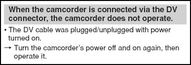

I have a JVC GR-D30US MiniDV Camcorder and all of my applications just show the message : "THERE ARE NO DV CAMCORDERS ON THIS SYSTEM".
I also tested my firewire card and cable and it worked fine on another PC with a Sony camcorder...so...my card and cable are ok !
How could I test my camcorder DV out ? This model doesn't have an option on the menu to activate DV out, how could I "tell" windows that is a Camcorder connected on the Firewire port ?
Thanx.
Gabriel Brazil -
Well I don't know what help if any this may be but I downloaded the owner's manual for your camcorder from the JVC WEBSITE and this manual covers not just the GR-D30US but also the GR-D70US and GR-D90US models.
CLICK HERE for a direct link to this manual (Adobe Acrobat PDF format).
Here is all the information I could find:
This is from the troubleshooting section (yes this is really all that is says)
Maybe this will help.
