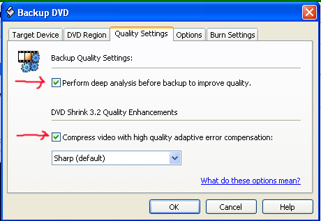

    Check these settings. On my pc it takes about 30 min without these check and 2½ hours with both checked. Depends on the quality you want.
