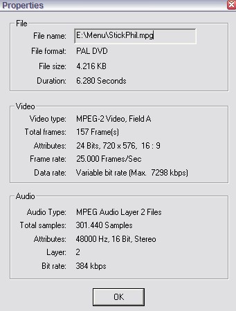

    Here are the specs of what I used in my most recent background in TDA:
    Works very well. I ripped it from a DVD. Loaded the .vob into MPEG-VCR and had it create the .mpg clip shown above.

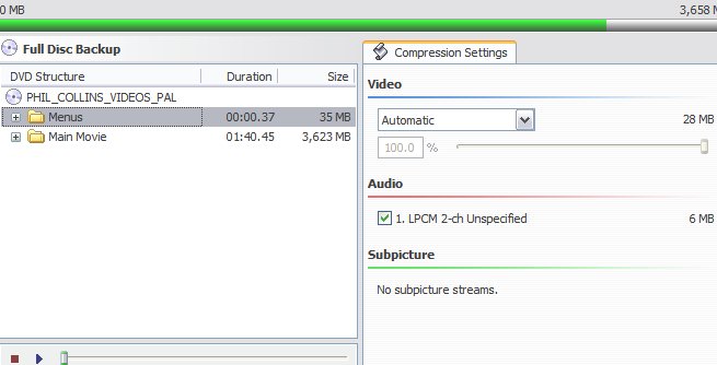

  24. Member hech54's Avatar
    Jul 2001
    Yank in Europe
    I input this into TDA:
    Originally Posted by hech54
    And this is what DVDShrink says the menu audio is now so I guess TDA converted the audio.
