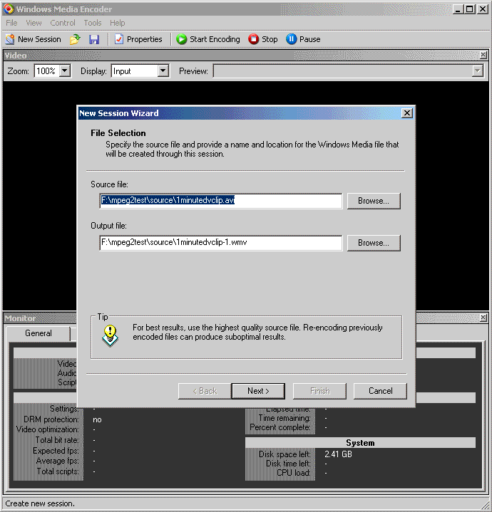

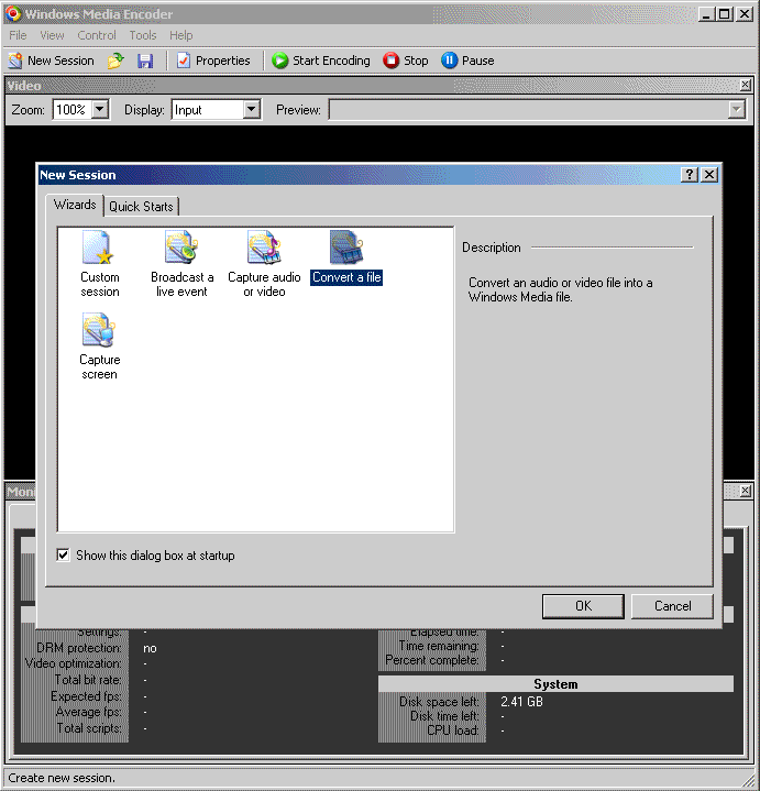

Click New session
Select Convert a file
Open the video, if you can't open it try install the Panasonic DV Codec. If you still can't open the DV try convert to DV Type 2 with DVConverter or Canopus DV File Converter or DV Type 1 to DV Type 2 Converter.

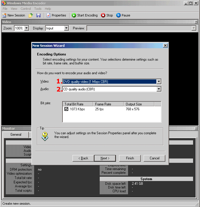

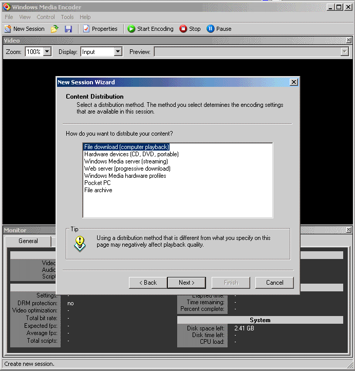

Select File download(computer playback)
1. Set the Video bitrate, I use DVD video quality 1 MBits CBR
2. Set the Audio bitrate, I use CD quality CBR

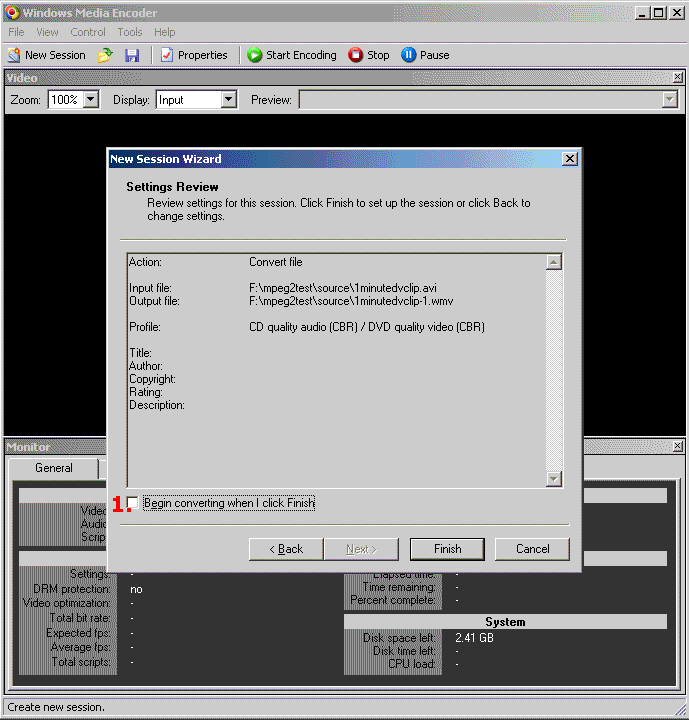

Disable Begin converting when I click Finish

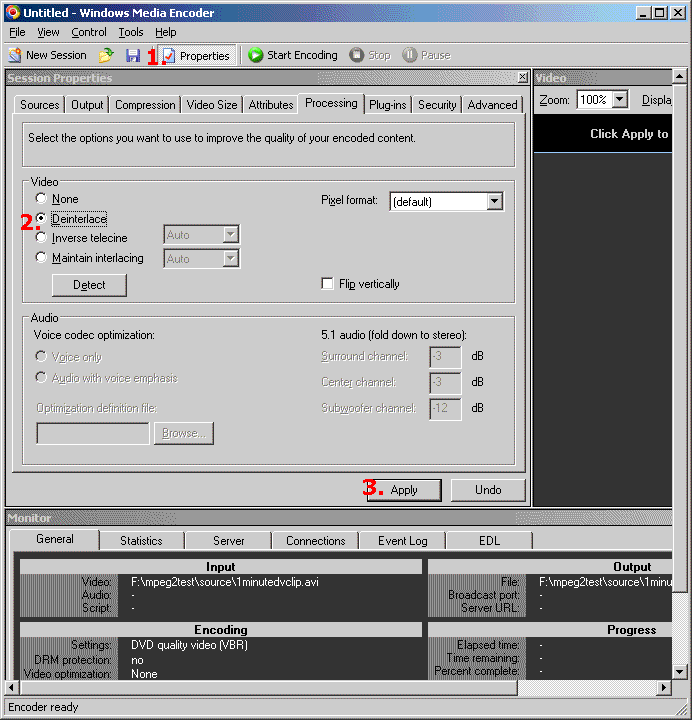

Deinterlace
Most DV Cameras captures interlaced and if you watch it on your computer you will notice interlaced lines so we must remove them by deinterlace the picture. Read more about interlace over at www.100fps.com .
1. Select Properties
2. Under Processing select Deinterlace
3. Apply

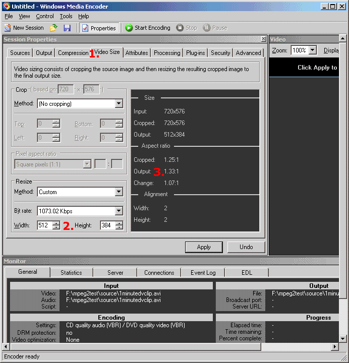

Video frame size
1. Select Video Size
2. Change the Frame Size to 640x480 or lower. Some common 4:3 sizes are 640x480, 512x384,384x288, 320x240
3. Be sure that the Output aspect ratio is 1.33(4:3)
If you use lower video frame size you can decrease the bitrate and make smaller wmv files and still keep the video quality pretty good.

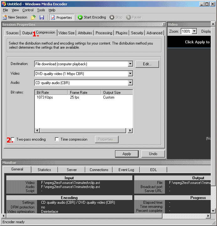

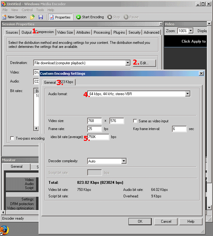

Compression
1. Select Compression
2. Disable Two Pass Encoding ( you can enable this if you want better quality but it will take much longer to convert)
Custom video bitrate (this step is optional)
2. Click Edit
3. Click on the xxx kbps
4. Set the audio bitrate
5. Set the video bitrate
You can use our VideoHelp Bitrate Calculator to calculate the bitrate. If you use low bitrates, below 750kbs, be sure to lower the video frame size also or it will look really bad.

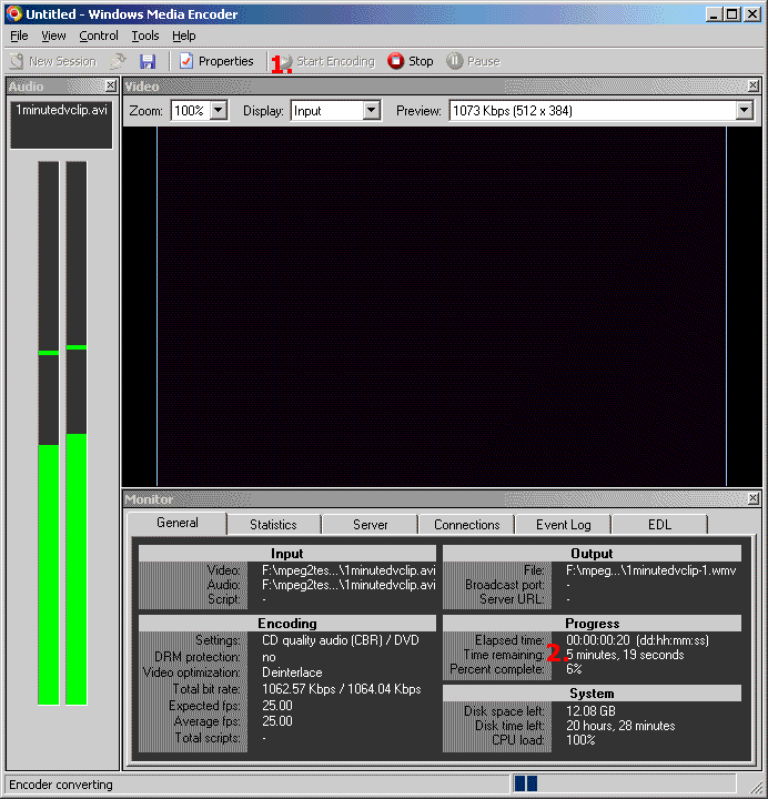

Convert
1. Last Hit Start Encoding to convert
2. Check the time remaining...windows media is slooooooooooow on my Athlon 1.2GHZ, 6 minutes to encode 1 minute video.
