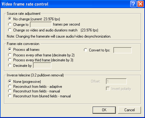

Now go to where you can change the video frame rate.
It should look something like this:
Notice where it says, "No change (current 25.000 fps)"
That is what you should see.
Now notice where it says, "Change so video and audio durations match (24.999 fps)"
In my example it says 24.999fps which is most likely A-OK although it would be optimal if it said 25.000 fps here instead of 24.999 fps.
If it says 25.000 fps then it should be in sync. If it is very damn near close (like in my example 24.999 fps) then it should be in sync without having to make any changes.
If it is off by more than this very tiny small amount then you will very well most likely have an A/V sync problem.
In that case I would checkmark the option entitled "Change so vidoe and audio durations match ..." and then frameserve to your MPEG encoder. This will work for instance if you use TMGPEnc Plus as your MPEG encoder but your video FPS will be something otherthan 25.000 so another MPEG encoder (such as CCE) may barf on that but I know TMPGEnc will work A-OK in that instance.
This is assuming that the original AVI when loaded into VirtualDubMod has audio and video that matches ... in other words the original AVI should look like this:
Notice it says 23.976fps in both places. If the original AVI does not match exactly like this then it might still be in sync but sometimes these AVI files you find on the 'net are out-of-sync to start with and correcting that can be a nightmare especially with a NTSC to PAL or vice versa conversion.
