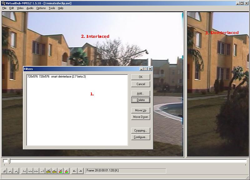

Deinterlace
Most DV cameras captures interlaced video, it means that you must deinterlace it or it will look like crap on computers. Read more about interlace over at www.100fps.com . If your camera captures in progressive video mode you should skip this step, progressive video = you should not see any interlace lines in the video(see the interlaced screenshot below).
1. Add the deinterlace filter, under Video->Filters, click Add and add the smart deinterlacer
2,3. Check the preview, the interlaced lines(2) should have dissapeared in the preview window(3).

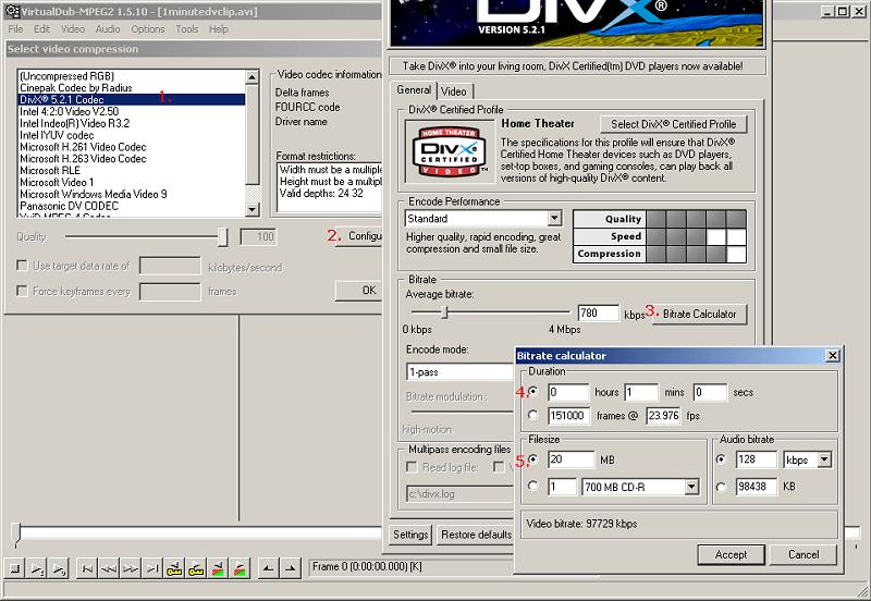

DivX
1. Select under Video->Compression and select the DivX Codec
2. Click Configure
3. Click Bitrate Calculator.
4. Set the time of your video clip
5. Set the output size in MB, bigger file means higher bitrate means higher quality. You can try encode some clips with different sizes and see how it looks like.

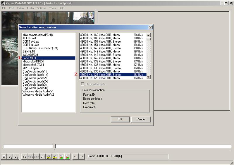

MP3 Audio
1. Select under Audio->Full processing
2. Select under Audio->Compression, select the Lame mp3 codec and 128 kbit/s.

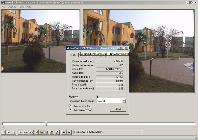

Last select File->Save as AVI to make the DivX or XviD.
Done.
