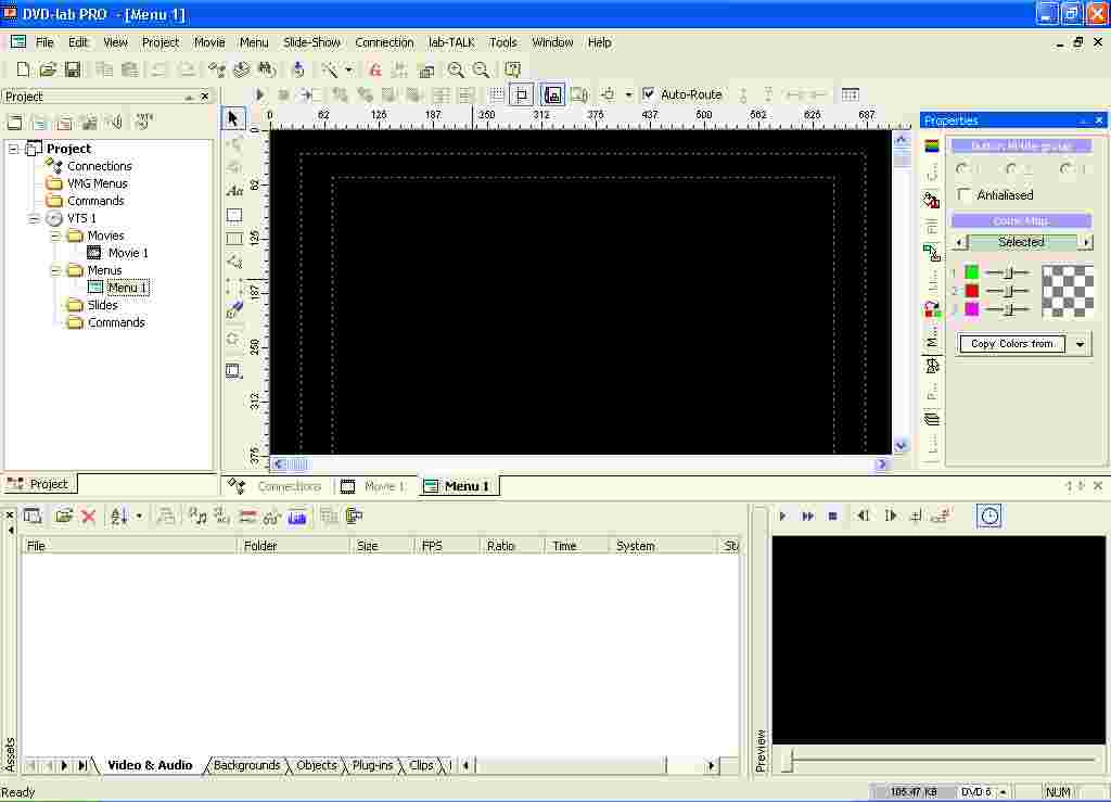

  5. Member Safesurfer's Avatar
    Mar 2004
    See image for clarification, the trial is not crippled in any way.

  7. Thanks for the graphic.
    Like I said, I'm going to have to look at this tonight, but I don't seem to have access to that part of the the properties window. I have a few effects and so forth that can be applied to the objects in the menu, and these are all listed on the right like in the graphic above. But I do not seem to have any other tabs or active choices to toggle between my properties functions and the color map shown above.
    I will post an image of my screen when I get home so you can see that I'm not crazy (???).
    At any rate, the screen above shows exactly what the help files describe, I just don't seem to have my screen configured like everyone else. Incidentally, I can simply close or open the properties box. But I don't think I can change the actually functions in the box. This is yet to be determined though.

  8. I'm embarrased to say that I was ale to toggle to the button map choices.
    Thanks for the help!!!
