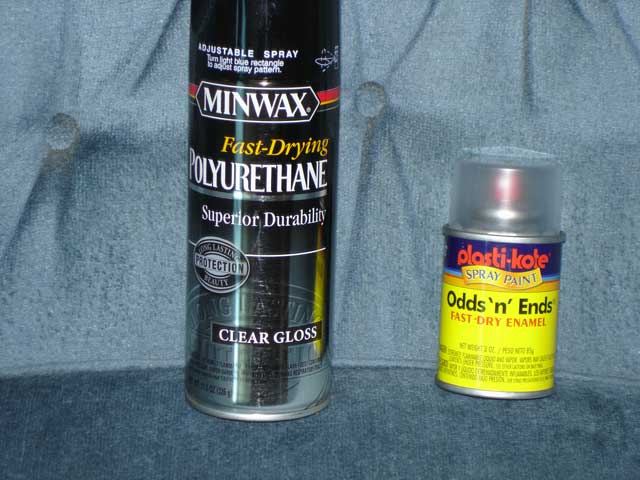

    I hope that I've found what some people here will find acceptable. I tried the P. Nimocks stuff that everyone else is raving about, both gloss and matte and had terrible results. The stuff would almost bead up like water on a newly waxed car's hood. It didn't actually bead but it did leave small uncoated circles showing unprotected ink surface. I had similar results using Krylon high gloss Crystal Clear (#1301). My theory is that these sprays contain lacquer which is not meant to be sprayed on plastic surfaces. So, off to Wal-Mart I go looking for some clear gloss coatings that are compatable with plastic. The first I found was "Plasti-Kote" spray paint (#119S Clear) in a tiny 4 in high spray can. It's cost was $1.97 for 3oz. The second I found was "Minwax Fast Drying Polyurethane" clear gloss. It was the normal size of 11.5 oz for about $6. After arriving home the first I tried was the Plasti-Kote. I placed my disc on some newspaper and placed a weight on the center hole to press it tightly against the paper. I sprayed from about 10 - 12 in and was able to apply a smooth even coat. It has dried quickly (15 min) into a smooth very level surface that has a finish similar to glossy photo paper. Very happy with the results. I applied the Minwax spay in similar fashion and it too has produced an acceptable finish. The Minwax has a higher gloss to it but not as level a surface as the Plasti-Kote. Another thing that may be of help to some is that the Minwax has an adjustable nozzle on it.

    Here's a pic of what I used:

  7. Originally Posted by mowermanEd
    I found this to be temperature related. I had the same problem spraying at night, but on a bright sunny day, I didn't have the same problem.
    Sprayed them all the same exact way, just at night and mid day

    Funny you mentioned this Stiltman. Yesterday it was rather cold out in the garage so maybe that's why I had problems. I wait for a warmer day and try the Krylon again.
    IMAGE DELETED
    Never thought of polyurethene but I was thinking
    about acrylic lacquer.
