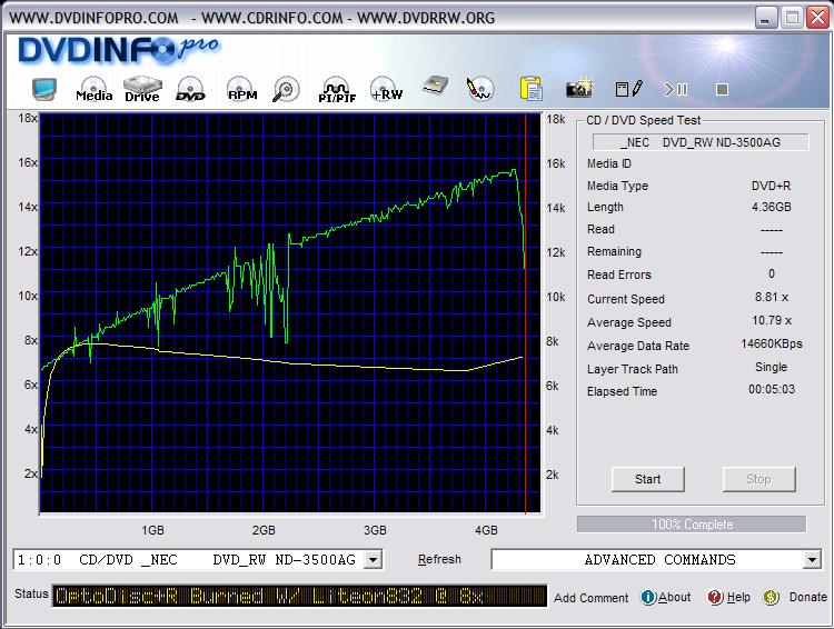

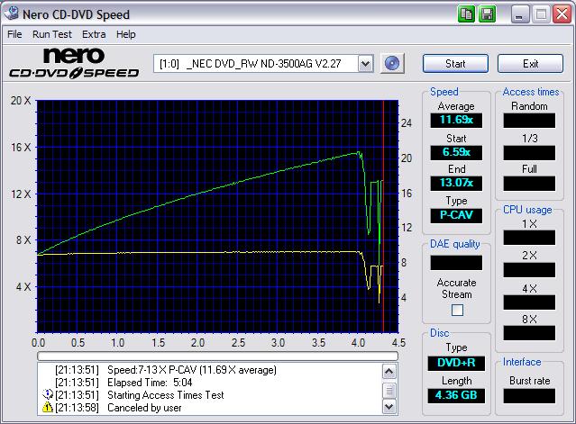

    DVD Speed - NEC
    Obviously not the greatest discs..readback slows towards the end on this scan.

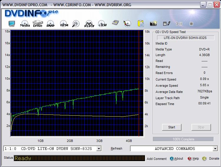

    Will do another DVD Speed with my liteon, as my NEC dosnt seem like a fantastic reader. (It is decent, but seems to slow down towards the end on a majority of discs).
    DVD Speed - Liteon

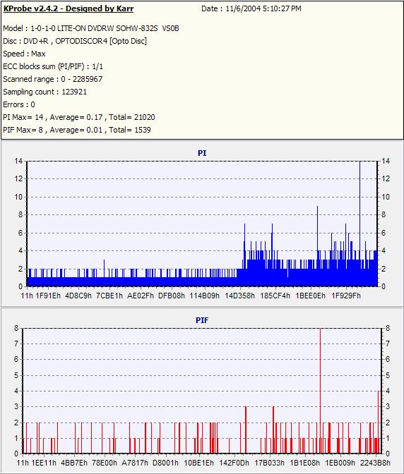

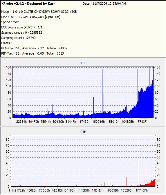

    Hmm...on second thoughts, maybe not.. Here's the krpobe of a disc burned at 8x...still playsback / reads back with no errors...but a bit spikey.

    Heh. Just did the ultimate test on the 8x burns.
    Playing them.
    Results?
    5seconds great play *skip skip skip* 5 seconds great play *skipskipskipskipskipskip* 2 seconds *SKIP*
    Goes to show how much kprobe / CD speed really mean. 8x burns are all garbage on these discs.

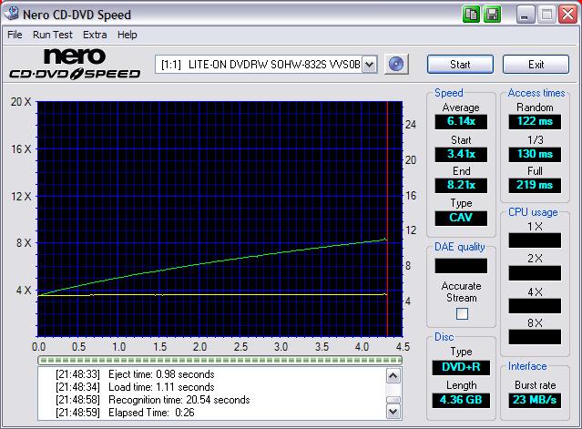

    Guess i hadnt used them all up...(they came ni 4 spindles of 25 each)..
    Burning these at 4x on my liteon instead of the NEC...Very good.
    Play back fine, no skips/pixelations/pauses etc...
    I'll post some scans in a few minutes...
