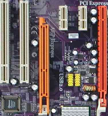

    Do you mean PCI-X or PCI-E? Whatare the differences between PCI-X and 64-bit PCI?

    I meant pci-express. the tiny narrow connector.
    pci-x, technically, is pci at 100 or 133mhz instead of the 33 or 66mhz.
    then there's double wide pci which is 64bits instead of 32. the normal pci connectors typically found are only 32bits wide yet the bus might run at 33 or 66mhz.
    what I wanted was the 64bit wide and 66mhz (or faster) bus so that my raid (and gig-E) would run at their best and not be bus-limited.
    currently, I don't know of any device that really justifies pci-e yet, for me. I'm more into network and i/o speed than graphics - so pci-e isn't a draw for me, at all.

    I run an Iwill DH800 now. That's got two PCI-X slots (not PCI-E, though PCI-E will also accept previous PCI cards IIRC) and two 32-bit PCI slots in addition to the AGP slot. It uses Adaptec Host RAID so I don't think that's a true hardware RAID controller or not; I don't use RAID so it doesn't concern me much. It does use the 6300ESB ICH which was a big selling point over the popular ICH5R chips. I've been told it's one of the best ICH chipsets. It also uses Intel's CSA GbE controller that bypasses the PCI bus and goes directly to the ICH.

    PCI-E is not backward compatible with PCI. PCI-X is backward compatible with most PCI card (although they will only run at 33MHz / 32-bit). Seating between PCI and PCI-E is a bit off.
