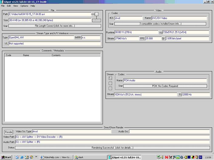

Look at your Gspot screen shot. It shows the audio as being 32khz!Originally Posted by dano182
Try this.
Open the avi in virtualdub (the Panasonic codec will allow this).
Select Audio->Full processing mode. Audio->conversion (select 48khz). File-Save wav. Give the wav file a name and save out a copy of the audio.
Now still in virtualdub, select video->direct stream copy, Audio->wav audio, and select the newly created wav file. Now File->Save as avi.
This new avi will have the audio at 48khz. See what you can do with this. -
