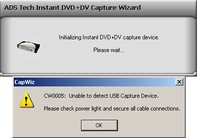

  9. I have installed the v3.5 of CapWiz for InstantDVD because you guys told you it would detect my Device Profile or whatever, but it gives me an error message saying it cannot find my device even though the device is plugged in, hooked up properly and is clearly identified and drivers installed for it in Device Manager. I have a USB2.0 cable, so will I be able to capture at 15k? What are other programs I could use to capture the video at 15 or higher bitrates? Someone should make a small program for TV to PC capture that is small like WinDV is for DV cams.

    Sorry that you are not having an success with your device. But imo,
    it should work. Did you try using UL instead. There are two place to
    try under File menu. One is Plug-ins and other one is just above it (or
    two, though I fogot the name of the option) But that's in UL 7SE.. not
    capWiz. I'm using UL 7SE because it works much better (though startup
    time is slow when capturing) but it shows all my other capture devices..
    DV cam; ADVC-100; ATI Rage Furo Pro; Winfast; etc.
    As long as their is a properly installed set of drivers, UL 7SE should
    see it and include it in it's list of capture devices. Maybe you have
    to re-install UL 7SE again (after you install your capture driver(s) that
    is)
    EDITED -- see above.
