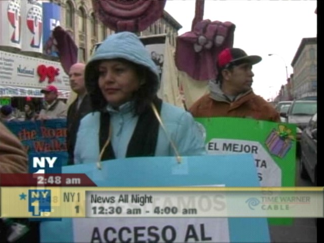

Ed, I installed the Analog TV Tuner card with a Digital cable box, it works fine and get all the channels, but at the right side of the screen I get a small vertical black bar, Is that normal? I can't seem to get a picture up in here so you can see. Im using Quick TV software to watch, it came with the package. As for the component to RGB adapter, does the adapter have to be 1920x1200 (compaible) HDTV resolution?, because I've seen the same adapter but only go up top 1280x800.

Hi again,Originally Posted by bambamrl
Which analog tuner card is it? Your link didn't work.
Is that right side bar in all channels (i.e. those from the tuner and those from the s-video connector) ?
What is happening is a horizontal shift of the picture left relative to sync.
Look for overlay controls in the setup menu. It may show as horizontal position, horizontal phase or blanking adjustment.

I get the black bar with either cable or s-video, but I currently have it connected on s-video since I did the test and saw that s-video had a better picture quality(less ghost). That black bar is on all channels, just sometimes, on some commercials, will I get full screen. The only thing that is always the way it should be displayed Horizontally is the bar that comes up when you change the channels, that gets displayed fully from left to right side of the screen.

The Quick TV software does not give me those features, except for aspect ration which I have it on 4:3 and video system, have it on NTSC-M also has NTSC-J
Danny -
My ATI All-In-Wonder has those menus under ctl panel - display settings advanced. You may find them there
Interesting that the cable box overlay goes all the way over.
TV sets overscan so that edge problems are hidden. If the card has no overlay adjustments, you may have to live with it.
