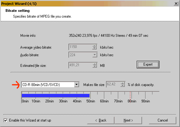

Ok I found a pic, see the box in the lower right corner, when its clicked on ntsc dvd it says something different in the pic, anyways anyone tell me which one to pick ?

Screenshot: From that, I'd guess you're using the wizard. Go way back when you asked for a guide and I provided one... Well, ditch the wizard and configure TMPGEnc manually. That way, you have total control over the settings. Read the guide carefully, and follow it closely - there's loads of very useful info in there and it's easy to miss it...

I guess you have selected PCM audio on the first page of the wizard.
Change it to MPEG-1 Layer II Audio (MP2).
Yep I have it set to pcm audio, so if I switch to mpeg-1 layer II audio what will this do ? Will the file be smaller ?
Also here is the pic, see the audio bitrate, mine was set at 1536 and I could not lower it at all. I unlocked it but still could not change the number
