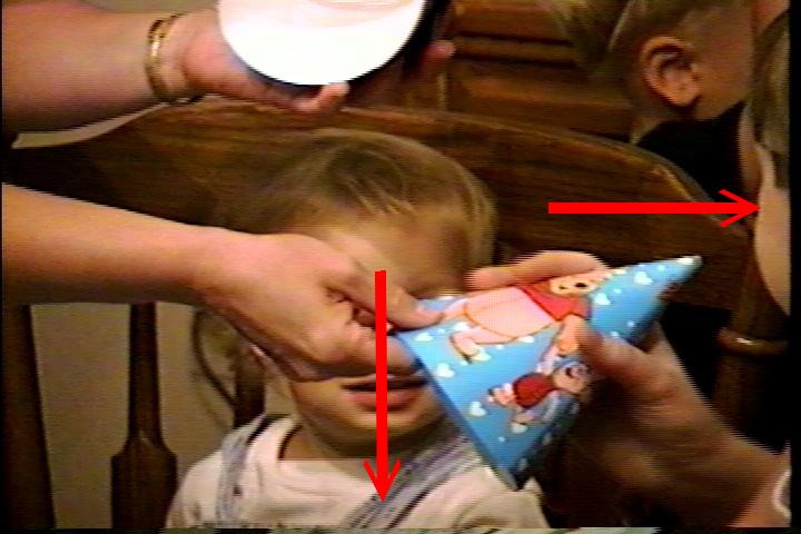

could you post a screenshot? open the captured material in Media Player Classic and File->save image.
Does it look like this:
If so it's normal, it's called overscan and won't be visible on a TV just your computer. -
Kolosus upload short video clip to ftp.shspvr.com/inconing/ and I take look at.
In thecoalman screenshot the bar is normal sometime it can be on left or rigth of screen sometime even the bottom or top of the screen -
The screenshot "thecoalman" posted is very close. There is no distortion on the bottom, but the black line is correct except you can see the video on both sides of the line. Barely mind you, but it is there.
This is normal!? So I'm going to have to crop every capture I want to save to computer only? That kinda sucks.
"It is not enough to obey Big Brother. You must love him". -
I haven't seen any with the double line like you have but it still appears to be outside the viewable portion of a TV.
You can either crop or mask it with a border, I suggest the mask as it will leave original size in place. -

Doesn't matter what card you use unless they make a card that auto crops while capturing or the video uses the entire resolution (the only I have seen so far is D8 and Mini-DV).
That's always going to be present for the most part, like I said that's normal. It can't be seen on a TV which is why it's there. -

This is the common problem of overscan. TV signals are made for TV sets, not computer screens. The vertical and horizontal width controls on a TV set are adjusted so that you don't see about 10-20 % of the edges of the video image. It's call overscan on the TV set, and when video is produced, both in the viewfinder of a studio camera and on the CG, there is a safe area box that lets the producer know what will be shows on the TV. So, when viewing video on a PC monitor using a video capture card you will see more than what you will see using a TV set. So, you either have to live with the garbage at the edges of the video image, or you will have to crop the image. But remember if you crop the image and then play the video on a regular TV set, you will loose another 20% or so of the image. So, whan capturing for TV (DVD, VCD,SVCD) you should capture ALL of the video image and not crop it, so it will look the same as the original when played on a TV set.
