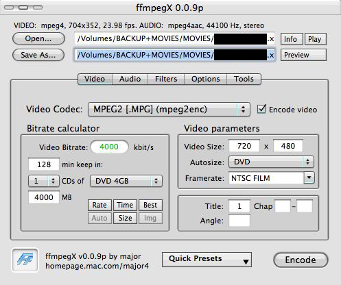

A quick question that has almost had me stumped. I have a Quicktime MOV movie (and various others), when I drag it to the ffmpegx icon it loads up the following after I choose the DVD mpegenc preset:
OK, so the preview information at the top says the framerate is NTSC Film, all fine and good, but when I click on more Info button, I get info telling me it is fps:29.97 (Normal NTSC). When I encode at Normal NTSC, the movie plays fine when burned to disc and played on my Sony DVD player.
When I open the file in Quicktime and get properties, it says the framerate is 23.98. What is going on here? Surely if the framerate is NTSC Film, then when I encode it as 29.97 there should be a problem? But there isn't!
All the movies I have encoded as 29.97 have had 23.98 info. I'm just wondering if this is correct.....
