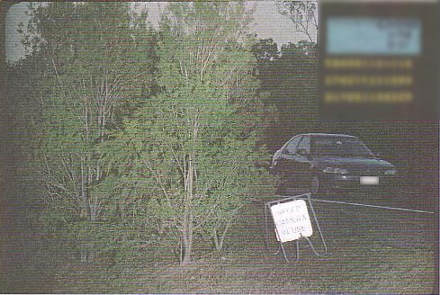

    I was going 16km over the speed limit according to the ticket. I was caught by a speed camera which is basically a 4WD with a radar mounted in the back that automatically takes your picture if you are over the limit.
    I still haven't decided whether or not I'm going to court, whilst I don't have to because I have enough points left on my licence I still think I should based on the dodgyness of the situation.
    Have a look at the photo and see what you think. Cap, do you think the trees and the metal sign in between me and the camera could affect the radar?

    What you described with the sign being clearly seen is a very rare occurence. Normally (as seen in the picture) you only see the sign once you've been caught.
    I've also heard of the privacy thing with front on shots. The thing that pissed me off was that it was dark when I was driving and the thing flashed right in my eyes.

  30. Master of Time & Space Capmaster's Avatar
    Feb 2004
    Denver, CO United States
    Originally Posted by pacmania_2001
    Thanks all for the advice.
    I don't know without knowing the antenna pattern on the gun.
    Usually flat metal objects generate huge return signals. If that sign is metal there's no doubt multipath going on. But ...the gun probably discriminates out the "0 MPH" return signal and instead bumps up the amplification of the legit signal.
    The tree's interference is probably a big factor, but the effect would be to dampen or cancel the return signal from anything behind the tree. It may return a weak signal, but see above for why that probably won't matter.
    In that pic it looks like the officer has line-of-sight, but he's at an angle to the roadway so the doppler effect will be less than if he were on the shoulder pointing it straight back. It will read artificially lower in this case.
    How fast were you going Pac?
