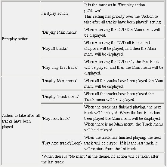

    Take a look at the bottom half of this image
    and choose the option most appropriate to you.
    If in doubt, Google it.
  5. Well that's the problem. I read the exact same information you posted in the help file, but under the actual menu, the second option is not "after ALL track", but "after EACH track". I tried treating that option as "after all track" and set it to "display main menu", but after each track is played it goes back to the main menu, when I only want that option for the final track. I must be missing something in the program.

  7. yeah, I thought it was a typo too. Something is screwed up in this program. It says if "play next track" option is selected for "action to take after each track", after finishing each track, it will go to the next track, if it's the final track, it will go to the main menu. Unfortunately, the DVD just "stalls" after finishing the final track, not going back to main menu.
