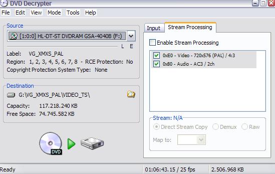

    Then how do you explain my $50 Apex clone Skantic DVD Player converting on the fly TO MY PHILIPS DVD RECORDER....which does not record a quasi signal?
    Here is a DVDDecrypter screenshot of a project I did for my brother. It is a DVD of an NTSC Only VHS Christmas with Vince Gill. First I put the NTSC tape to DVD with my Philips. Placed that NTSC DVD into my Skantic....set it for PAL output....then recorded it again to an RW....again back into my Philips.
    As you can see...it is now PAL.
