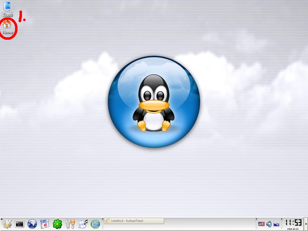

First go to your home:

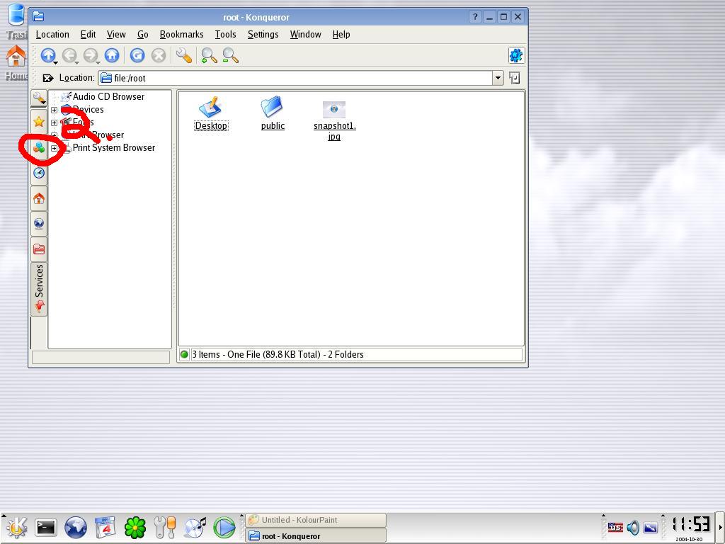

Now go to the Devices Tab on the side:

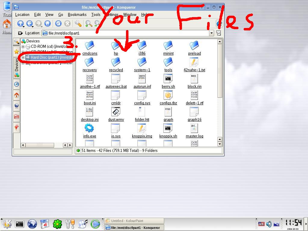

And finally go to your hard drive, it should read Hard Disk Part 1 /mnt/hda or /mnt/disk0. My computer is an hp with a recovery partition, that's why there are 2 on mine. Once you open up Hard Disk you shouuld see all your files just like your looking at the C: Drive.
After you find your files, go to the K menu, Multimedia, and K3b. You can now burn your files to DVD/CD. -

I had to upload three pictures so I'm not sure at what point you made this post- but yes you will be able to access files from all accounts because windows isn't running so you don't have to have permissions to access anything. As far as getting to "My Documents" just go:And that's where my harddrive should be? And will I have access to the files saved under my account?
C:\documents and settings\[your username]\my documents\ -
