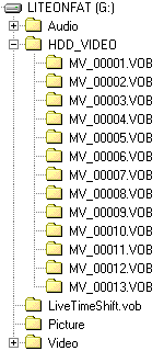

Well... I finally backed up my 120GB storage HD... Formatted it as FAT32... then popped it into my DVDRHD04.
Turned it on and clicked the browse btn on the remote. As expected it showed nothing available. I then fed a video stream throught the S-Video port and pressed record. The not available (circle with a slash in it) icon appeared in the top right corner of the screen.
I clicked the tools button on the remote and erased the HD. After about 2 minutes, it finished. I then pressed the record button again and voilla... it worked perfectly. I record everything in SP mode, and while it was recording, it stated that I had 33h 43m 48s or record time available. I can't remember what the 80GB drive stated for available record time in SP mode when it was empty, but I am pretty sure it was well shy of 33 hours.
Here is the file structure of the DVDRHD04 80GB HD with 13 recorded clips on it:
I forsee my first MOD in the near future. I'll get back to you later on that. -
