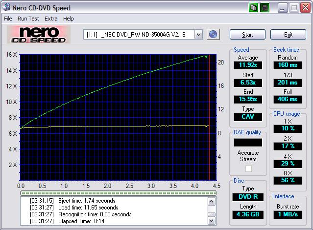

    latest batch of Supermediastore 8x printable DVD-R's are F01. More results coming soon..will run CDSPeed, Kprobe etc etc.
    Burning at 8x with a NEC 3500AG.

  2. Member Fandim's Avatar
    Jun 2004
    Reno, NV

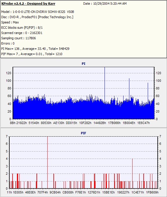

    Here's a kprobe.
    And here's a CDSpeed.

    It also burns fine on my Liteon 832.. Maybe you just got a bad batch of media?

    Don't worry so much about kprobe. That's just one test. How do they play back, read back data?
