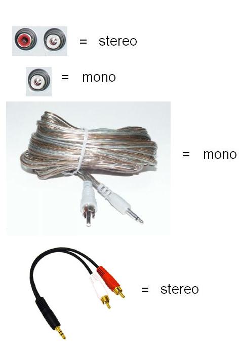

    You need to get an adapter - "RCA phono jack to 1/8" plug". That goes into the blue jack. I can read it in the pic and it says "Audio In"
  3. Like Capmaster said but as a photo:
    Don't forget to check your sound card software mixer
    is set correctly.
  4. Thank you both.
    What's the stereo cable to video audio out look like and when do I need it? My VCR isn't anything fancy, it only has the video out and one audio out (white). That means it's mono right? So, I don't need that stereo cable? If you could put a picture though so I can see it, thanks.
  5. Originally Posted by Crunk
    Thank you both.
    No, in that case mono is fine. On some VCR's RED is instead black.
