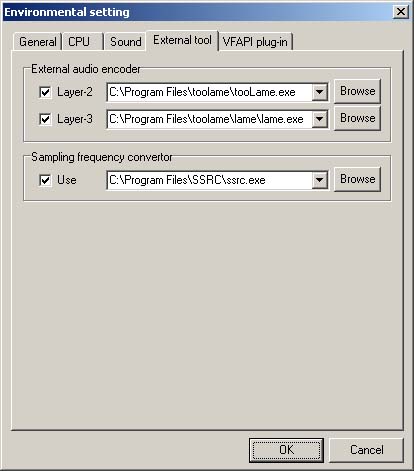

    MPA: Shorthand for MPEG Audio elemantary stream(no video). Also called MP2 for MPEG Audio Layer2
    As it sounds like you're gonna use TMPGEnc, look into the MP2 tooLame encoder that TMPGEnc can use as an add-in. It's supposed to be better than the inbuilt one. While you're at it, you might as well get Lame and SSRC too (do some hunting around if you don't know what these are - you'd get a better answer than one from me...)
    Just put the files in their own directories (mine are under "Program Files") and then set-up in TMPGEnc as per below:
