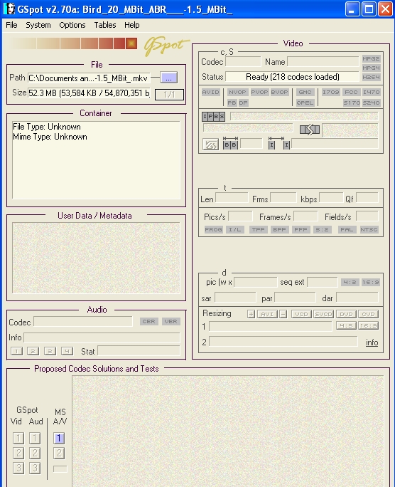

For displaying more information on an MKV, use MediaInfo (especially Tree View). GSpot's support for containers other than AVI and MPEG/VOB is rather limited and/or incomplete. I still keep and use both, though.If cameras add ten pounds, why would people want to eat them? -
