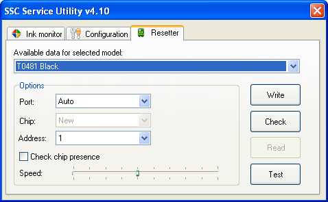

    Thanks Guys, have downloaded the software, but can't see how to get it to reset the printer.
    Have a nice Day
    Apr 2003
    Maryland
    You right click the icon that is on your task bar and choose reset protection counter. It will ask whether you changed the waste pass. You say YES. The reset it. I would turn the printer off and then back on
    No DVD can withstand the power of DVDShrink along with AnyDVD!
  14. Member mikesbytes's Avatar
    Sydney, Australia
    Thanks jtoolman2000, I didn't spot the right click menu. Reset successful.

    I am using SSC service Ultility ver 4.10
    please help
    thank you
