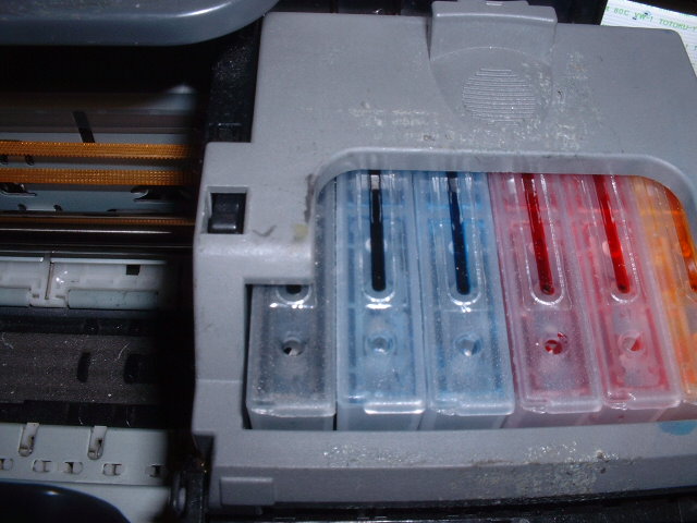

    my cartridge are pics below vvv

    Yes Locky, That's where you fill them but without the hoses you'll need the plug for the hole. The plug looks exactly like the ones on poolenglish's carts but because there's only one hole on the JLW carts the plug has a small hole in it for a vent. It'll let the printer pull ink but no vent will cause no ink to come out and the rapid movement of the printhead will cause spillage without the plug. You can look at the $21 refillables at the Waytoprint E-bay store. They're spongeless and look really good but $21 gets you no chips....the link is on the last one or two pages in the "Best Cis forum". If you can't find it I'll post it for you. Let me know if you can't find the link. LOL!

  12. Mac, tried to fill but ink only fill to the small chamber (the upper right) under the hole ? any treat that I missed ? thx
  13. Originally Posted by locky
    locky;this link will help for refilling 1 hole carts
    http://www.inkbank.com.au/category56_1.htm
    I prefer the 2 hole carts like i have.... because the carts never have to leave the printer. good luck.

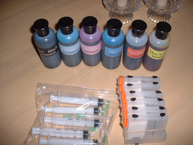

    btw www.printforless.tk is where i bought the refillable carts. they have a sponge(foam) in the feed side, auto reset chips installed.
    also, this is the new version he has which can be filled while in the printer.

    I emailed him, he invoiced me via paypal and I had the ink and carts in 3 days .
    The set still works great and I have printed a lot.... three refills so far and it is simple to refill . I especially like leaving the carts in the printer to refill, no wear and tear on cartridge connector pins.

  23. goldthorne; the link for my refillables is just above yours. I bought the ink from him also. (pics are earlier). I drained the ink from my jwl and filled the new carts with it, wortks great!
