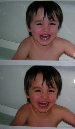

    RickTheRed, can you scan the two printouts and post them, or is the difference so slight that we wouldn't see it online?
    Mikesbytes,
    I do not have a scanner, but I have a digital camera. I will try to take a picture of both printouts. I will post the result when I'll get home
    @madvideos: I have set-up the same way. I've followed the picture on this thread.
    @all owner.
    It's my first CIS and when it's printing, I have the feeling that the cart will destroy the ink plastic tubing everytime the cart is moving to the very left. So far so good, but I can't stop watching this thing.

    @mikebytes:
    I have taken a picture not sure this will really help you, but here we go:
    Top one is JLW ink, bottom is Epson ink. Same settings for both. In real life, the bottom one looks less dark.

    RickTheRed
    Thanks for the photos
    The top one (ie CIS ink) looks better to me, but how do they compare with the origional?
    Also, has anyone messed with the settings to tune the R200/210/300/310 to compensate for the ink difference?

    Originally Posted by mikesbytes
    RickTheRed
    The original is a digital picture. Both pictures were printed with the same settings. There is a difference but it does not bother me: I am not a pro photographer. Just a question of getting everything calibrated, what I will not do.
    RickTheRed, could you please publish the original picture.
