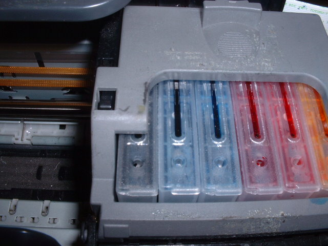

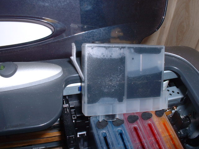

  10. Here are pics of my new refillable carts, the kool thing is i can refill in the printer and i can tell if one is empty by the colored line(chamber) running across the top.
    [/url]

    the refillable carts come delivered empty, with rubber stoppers on both ends. after filling both ends....You have to leave the stopper on the tank side off for a vent. or it becomes a sealed chamber and ink will not be able to flow.
    You might want to consider this method rather than CIS. Those hoses flopping around gets kind of annoying. And after all, the point is to save money.
    I was told that foam is ok and there is also a filter in the supply side.
    I printed about 900+ cds since dec 04 with the jwl cis and was satisfied. But the hoses and configuration are a pain. I wont mind filling the new carts, because they will never leave the printer to be filled.

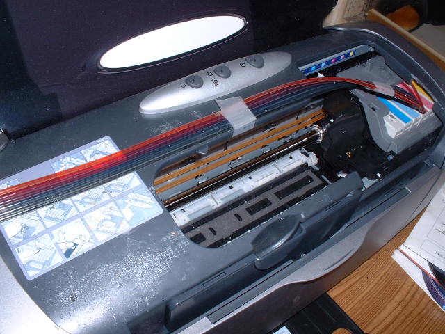

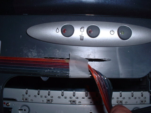

  29. After many different configuration trys (you can see the duct tape marks) I ran mine like this for 6 months smoothly
    I cut a slot to hold the tubes like this pic below.... and I did not connect the tubes on the carts to let them freewheel back and forth (I removed the sticky holder near the carts)
